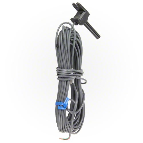

I’ve managed to find what I think is a replacement sensor, the “TS-5T TEMPERATURE SENSOR, 10K,” which seems like it is a 10k. Does it seem to you that this is the item to get? Also, from shopping online it looks like sensors come with only about 20 feet of wire attached. Would you happen to know the proper wire necessary for extending the run? I have to go close to 100’ all together. Thanks.
I gave you a link above to the correct TSSL sensor.

Actually came across our old Lx220 SOLAR CONTROL SYSTEM Installation & Operating Instructions which indicates the original part used was a “TS-ST Temperature Sensor,“ so I’ll shop for that. I would love to replacer the whole wire run from our rooftop to the controller because the old wire has been in the sun for years and is looking pretty cooked, just thinking it would be very good to replace, if I knew exactly what wire to use for replacement.

Oops! “TS-5T” temp sensor as per the manual.
Yup, and I think any 2 wire 20 gauge solid copper outdoor rated will do for the wire.

Okay, now I’m really making myself a bit crazy. I’m shopping online for a TS-5T temp sensor, assuming that my rooftop sensor is the likely culprit, but it occurs to me that as I was rebuilding our system last year, I didn’t pay real close attention to the sensor I used for water temp, the one clamped into the PVC pipe. Now I’m wondering if the generic air/water/sun sensor I put there may be causing my problem. Should I be shopping for two TS-5T’s to replace them both, I wonder? Do you think using a TS-SL or some other sensor instead of the prescribed TS-5T possibly throw the whole system off? As we’ve discussed, I don’t ever get a red light indicating service is needed, but the system does have the problem I’ve described.
