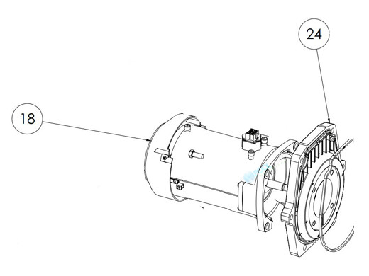

There are not generic replacements for VS pump motors the way there are for SS and DS pumps.
Get the Pentair motor or replace the pump.
The 2023 Pentair Pump Parts Catalog shows the parts. Confirm your VS pump is after 2018. Then the motor can be had for $663...
