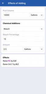

Curt, remember Stabilizer =CYA, not chlorine. Yes , CYA/FC relationship is the most important part of pool maintenance...disregarding it will start a swamp for you. Always stay at the top of your target FC + what you burn through in a day. Example, if your pool uses 4 FC a day, add 4 to the top number in the target range, that is where you want your FC to be at everyday after you add your liquid chlorine. A pool is like a pet, you have to feed it everday.
Do this....test your FC first thing in the morning, preferably before the sun hits it. Don't add anything all day. Test FC again at sunset. The difference between the 2 tests is what your pool uses that day. That loss is what you have to account for everyday and make up with chlorine additions, once a day.
I plugged in your 10k gallon pool. If using 10% liquid chlorine...1/2 gallon will raise your FC 5. 1/4 gallon will raise FC 2.5. You need to be adding around 1/3 gallon everyday to stay on top of everything. As it gets hotter, especially in Vegas, you will need to increase your CYA so that it will help protect that chlorine burn off.
