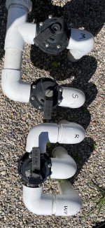

Here’s what I have. They seem to be in the correct position. I only have one return valve that supplies all four returns. The WF is my waterfall which I’m not currently running.

So following up, hubby solved the problem. Of our four returns, one of them was missing the 'nozzle' so the water coming out of it was basically full blast and taking away the pressure (or volume) needed to allow the other returns to work. once we plugged that one, the other two started working. So off to the pool store, I go to buy a nozzle that will help to 'reduce' the flow from that one single return.
