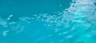

I am a very novice pool owner and I've only had my pool for approximately 6 months. I have been following this site religiously and I've had no issues thus far.
However, the pool recently began to get cloudy about 1 week ago (while I was out of the country). Which a friend have been managing slowly by adding extra chlorine and effectively slamming the pool consistently for the last 3 days. However I still am running into issues with it being cloudy (attempting to slam it). I was on vacation when this all began however suspecting it was a algae issue I had advised them to add generous amounts of chlorine following the pool math app to maintain chlorine levels of greater than 12. CYA was presently 30.
I checked the pool chemistry today and the results are below.
FC 12
CC 0
PH 7.5
CYA 50
TA 60
CH 75
I also recently removed the staircase from the pool which had some algae buildup on it approximately one cubic foot dispersed underneath the crevices of the actual staircase.
My question is is there anything else I should test in regards to this? such as an overnight FC lost test? Am I missing anything?
I also suspect the pool filter which is a Hayward sand filter is dirty and also requires cleaning as I have not cleaned it during my ownership period of 6 months. Furthermore, the PSI since I acquired ownership of the pool is always ranging from 15-17 despite numerous backwashing.
I am planning to clean the sand filter on Sunday. Just want to check if anyone recommends doing something else or if I am missing anything
Today I proceeded to backwash the filter as well as scrub the entire pool and vacuum it. as well as brush any crevices within the actual pool. There was some loose dust like algae on the bottom of the pool that "aerosolized" quickly with bruising the actual pool liner.
Thanks in advance!
I have also attached some useless pictures of the cloudy pool.

Thank you everyone for the help, we were able to finally get the pool under control it is now Crystal clear.
The FC this morning was 22 just as the sun started hitting the pool
CC 0
Unfortunately I was unable to check the FC yesterday.
But I am hopeful the slam process is complete. I added an extra gallon of bleach this morning to be sure.
I really appreciate all the help
