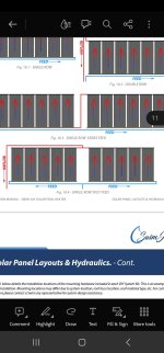

Did you make yours that wide with 16 or used some?
I used 15 and overlapped each one such that the total width is correct. Mine is about 3ft wider than it needed to be (yiu can see the excess distance in the center of the two split fed rows)

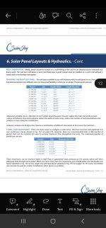

Looks to be about $1300 for the pipe and unistruts. I'm looking at the metal wall struts design to see how much lower the costs would come in so the rack doesn't end up costing close to $2300
So, the challenge with the metal wall struts rack mount is that it calls for different sizes of wall struts and the big box hardware stores only carry a single one that is probably even too thin a gauge.
UPDATE: home depot doesn't have these variations. In fact their online support is clueless.
That image looks labeled wrong. It seems as if those are steel studs not strut channel. If your local HD doesn't have the studs, check with a construction or drywall supply place.
Yes, it is the steel studs design from Tyler. I'm trying to price that option out.
This looks like it will come in much more cost effective than pipes and channel struts. I was able to get pricing from a local metal framing supply store.
According to Tyler he would expect the mount to outlast the panels (20-30 years).
