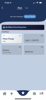

Hey all- I have been having problems with my hayward system picking up the flow sensor. I have this error on my app. I bypassed the flow sensor otherwise my pump kept shutting off. How can I “re install” the flow sensor and get it connected?
Back story- I had tried to install a mother board for my aqua rite and screwed everything up, so I took it out and now am having this flow sensor problem.

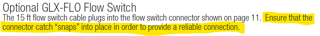

Do you have a flow switch plugged into your OmniHub here?
Do you have Flow Monitoring Enabled in the Configuration for the pump?
