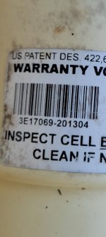

Show us pics of the cell.
What is the serial number of the cell?
The cell seemed ok until I changed the board. Do cells quit suddenly?
Your cell is 6 years old and likely near the end of its life. It looks like the new Purline board is not compatible with a well used old cell. The same thing may have happened with a new Hayward board.
Cells show their age and die in various ways.
I suggest you get a new Pureline cell from Inyopools which should be the most compatible with your new board.
