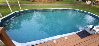

Hope all is well. I'm really happy with the results I'm seeing (see attached). The photos don't really do it justice but I'm noticing the green is fading fast and I'm sure there's a hint of blue in there, lol. I'll keep you guys posted. I'm really hoping it's ready before next week Thursday 🤞🏽. Thanks for all your help guys.
Also, I don't seem to be losing any overnight chlorine (had 16.5ppm this morning after adding from the 13ppm I had when I returned from the city yesterday. It also rained a lot overnight). CYA remains 40 and I'll have to check combined chlorine in a few hours. PH was really high so I added sodium bisulfate (supposed to add 3 but added 1.5 and I'll add the next after 2 hrs). Hope that's ok! Pool remains a bit cloudy but it's getting so much better!

Wooooohhhhoooooo!! Look at that progress!!
I’d go ahead and change the Poly and toss what’s in the bucket right into the trash - it probably won’t be salvageable.
Word of advice - if you plan to backwash and/rinse - make sure your bucket is elevated so it does NOT dump back into the pool. I’d also make sure when you take your bucket down to be super mindful of how full it is - that will surprise you!
Don’t freak out when you reconnect - even with clean poly - that some rust ends up back in the pool. All normal! It will cycle out!
Keep moving forward with SLAM too! I think you’ll be clear by Monday/Tuesday!

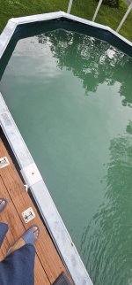

😭😭 hey guys. Woke up this morning. Pool didn't clear after the last SLAM 😭😭. It rained yesterday but the pool was clear. When I raised it from 8ppm to 16ppm it clouded up. I cleaned the cartridge filter, changed the polyfill (some rust went into the pool so I changed the polyfil as well and thank goodness no color change). It rained last night again so I couldn't tell you whether it cleared then got cloudy again ☹️ but photos are attached.
Here are my findings:
FC: 17.5ppm (didn't add any more since the last SLAM)
CC: 0.4ppm
PH: 8.0
AK: 110
CH: 300
Cya:30
I put a cup of liquid stablizer to go back up to 40 as per pool math. Everything else was fine. PH I didn't want to touch yet as I know rain can add to it. What do you guys think 😢?

No problem. You got this! Continue with the SLAM FC level. It might aggravate the iron which in your case is fine because you are still filtering. The more you remove now the better anyway. The chlorine will kill whatever caused your water to get cloudy. Normally a rain by itself doesn't impact TFP water so much, but odd things happen. Stick with it and you'll bounce back in no time. I'm sure of it. You have the tools and knowledge now to take care of it. :goodjob:
