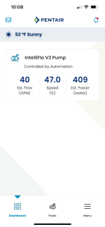

Good to know I will just turn it down to 35gpm. It was shocking to amount of extra load on the pump going through the heater. Below are the pump screen shots for heater and bypass at 40gpm. Equates to an extra $5/day of electricity just on the pump side let alone the draw for the heat pump. I would go with the Pentair 140HC if I had to do it again. Poor fluid dynamics design on this thing. Unimpressed, seems very well built otherwise. Probably designed with single speed pumps in mind….this thing throws away all the savings for having a variable speed pump.
The first is H = 0.03375F^2.
The second is H = 0.0075F^2
That puts the heat pump at about H = 0.02625F^2.
The heater should be about H = 0.00924F^2.
The heater is about H = 0.017F^2 over what the book indicates.
The heater is about 2.84 times more restrictive than the book indicates.
