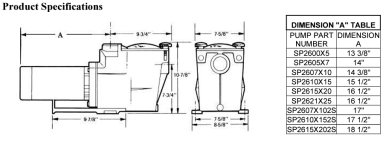

Here are the dimensions for your pump.
Here are the dimensions for the Hayward Superpump VSP sp2603vsp.
This would get you the same dimension on your input and would only have to rebuild from the pump to the MPV.

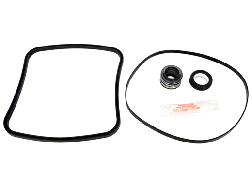

If you are happy with the performance of your Super Pump 700, you can get another. Since you have a union and a mission clamp, the install would be very easy.
If you want to just replace the motor, a Nidec Neptune NPTT165 with a Go Kit 3 (seal, gasket and O rings) would do the job for a bit less:
Reactions: PoolStored
