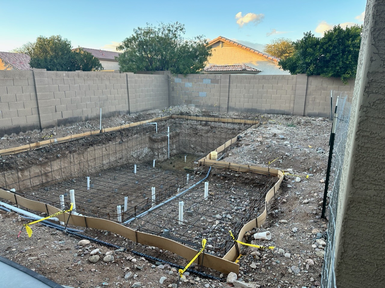

Can you show all pictures of the build?

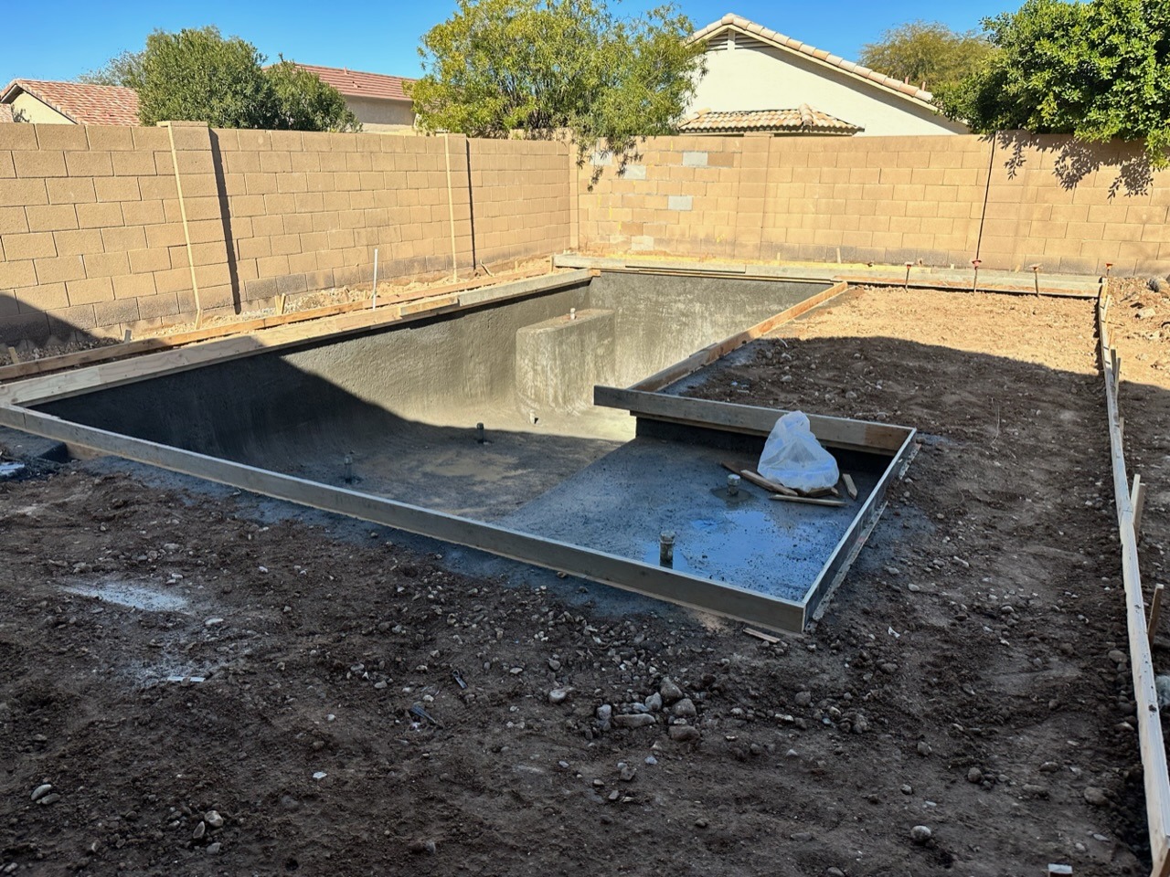

I’m worried since it’s all one piece of concrete with no rebar or anything that it might cause problems later. They barely even raked the dirt a little and just poured concrete and called it good. They put lines to make it look like sections or joints but it’s all one big piece.
The lines are crack control joints....
