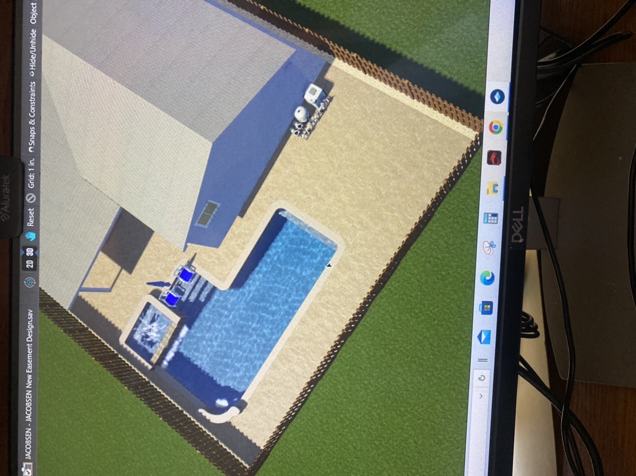

Hi All,
We are nearing the completion of our new inground gunite pool. We are using liquid chlorine (SWG will void our warranty). I previously had Liquidator with my Intex pool that worked great and now I am going with a Stenner Pump. I would like to get the timer built in with the pump (Econ Series), with the stenner tank included. my question is sizing the stenner pump for my needs. I have an 18,500 gallon pool, in direct daylight in Northern Ca. I read some threads and how to choose and install a stenner pump which was a great read. The E10T2B stenner pump would deliver 8.55 gallons per day. I have a VS Jandy Pump (One for the Spa and one for the Pool) model VSPHP270DV2A. Appreciate in advance the help.
Thanks
Tim
