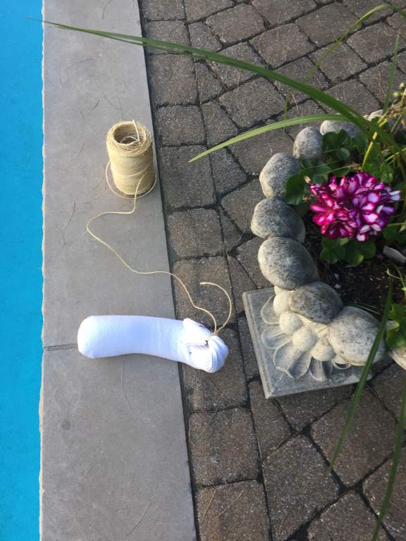

You can add stabilizer at day 4 for CYA 30. Use the sock method and DO NOT POUR IT IN YOUR SKIMMER the way the instructions on the package will tell you. Put it in a sock and suspend it in the water by a return. Do not allow the solid stabilizer to sit on the pool floor as it is a mild acid and can stain the plaster.

I usually place brick on the pool ledge to hang over the pool 2-3 inches, then hang the sock off of that. This ensures that with no/low flow through the return, the sock does not sit ON the pool wall, and instead 3-4 inches away. Just my $.02
