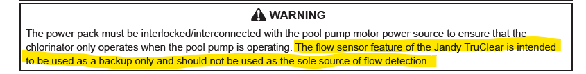

Pool company just finished the install, and was showing me the equipment. The circle box in the picture is a timer, he said its to put a timer on the salt system. because it will build up gasses, but that doesnt seem to make sense as then the pump is not running the salt system says no flow and i assume is not running either. why would i need a timer on my salt system?
Just for the pump run times, and that is done thru the iqpump-01
