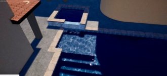

Hello Everyone,
My wife and I are getting ready to sign a contract with a pool builder and have some questions regarding the design and some feedback on the quote. Before I add some of the design pics here, I was wondering if it was OK to post them as they have the designers name and pool company attached. I can edit that out if it is not allowed. Just making sure I don't break any rules. Thanks in advance for all your help.
Thanks for your reply. We are in the middle stages of our planning, but let me tell you where we are right now.
1. We are set on the linear rectangular pool with off set spa.
2. The wall is goofy high because the equipment has to live behind that wall and so the permit says the wall has to be five feet. We have multiple pics of that walled tiered in different ways and I don't love any of them. The Pool Equipment can't live anywhere else that makes sense without a ton of extra cost, or reducing the pool size.
3. The quote is vague in parts and I know I need to get more detail, but what exactly should I be looking for. I understand how to price the equipment, but everything else is a bit of mystery.
4. SWCG is the current thinking.
I am sure I forgot to put in same basic things, so please ask away and I will do my best.
Thanks again for everyone's help.

Design of the pool: spillway of spa is too wide and will throw water onto the deck. Water naturally will get wider as it falls and from 18” and the spillway looks to be as wide as the coping of the pool under it.
Layout and excavation: Dump site charges, find out the cost and if it’s for dirt or secondary material. What if you have a cave in due to rain and who is responsible for the removal of soil to bring back the original form of the pool walls and or floor. Extra hours for excavation at what cost per hour? You are responsible for keeping the area secure from the public during construction (safety fencing)
Steps and Benches: be involved in the locations of these elevations in the spa so they work for you and your body height.
Plumbing: “hydraulically balanced” ask for the written formula (friction loss, run lengths, pump curvature) of how
they came up with it.
Shotcrete: ask for at least 1-copy of the Shotcrete delivery form to prove a 4,000 psi mix and how much time was in between leaving the plant and on scene for delivery and if any water was added after it was mixed at the plant.
Decking: because the p/b is not installing deck work I suggest that your deck contractor be on site during the layout of the pool to insure that the elevation is correct for the proper fall of the deck away from the pool and away from the house.
Equipment: I favor the Pentair Quad DE 100 filter when possible ( some cities do not allow DE filters), pentair globrite led 12 v. lights, pentair rebel pool sweep is expensive to replace parts on down the road.
Hope this gives you a few things to consider during the process, Ray.

Updated design and new quote. Would love any feedback on the quote or the design. I am pretty sold on this builder, so just looking for anything that strikes you all as way out of whack. Again, this is for San Diego County, so the costs might be more than other parts of the country. We don't plan on the umbrella or chair, he just added those in for perspective. Thanks in advance for your feedback.

I would consider cutting the step in the spa at a 45 so you can have an area to step in front to walk past the step instead of having to step around it.
Is the spa elevation at 0” ? When some one exit’s the spa it will be replaced by the water from the pool at whatever temperature that is. Unless you keep the pool water level below the spa spillway this will occur.

I like your new wall design. The tall wall blends a lot nicer. In theory it seems too high, but it could end up looking impressive. A member on here had a build with a 6 foot wall and it looked great. A couple of builders discussed a double retaining wall (another wall behind the pool wall but I'm not sure if you have the space to build that (we chose not to).
Thanks for the idea about the 45 on the step, I completely agree. I am sure the spa elevation will be above the pool level by a few inches, but it will be something I button down before we move forward.
