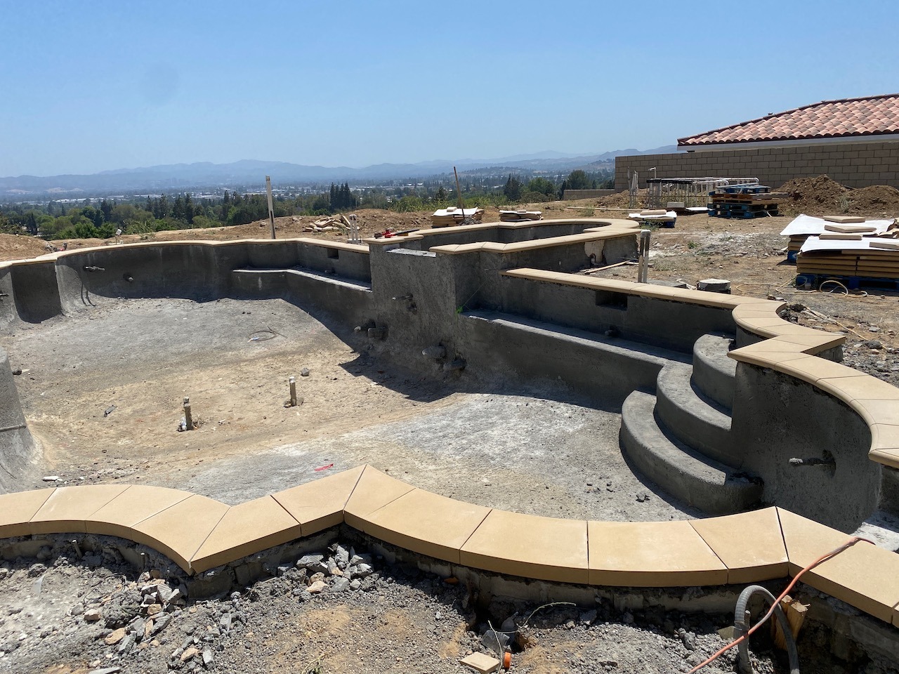

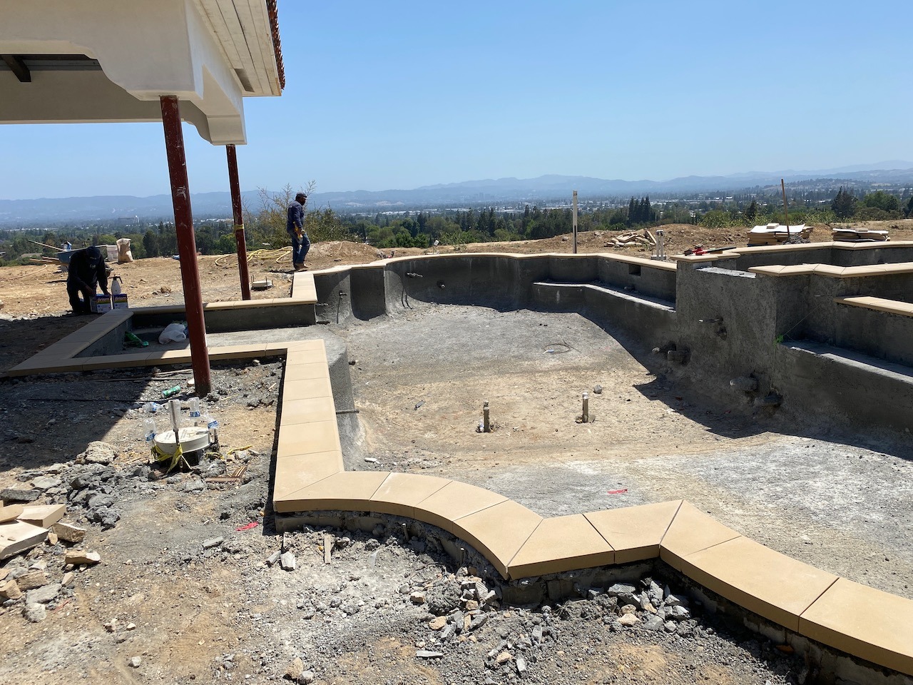

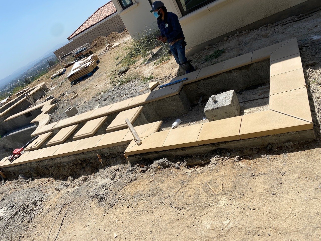

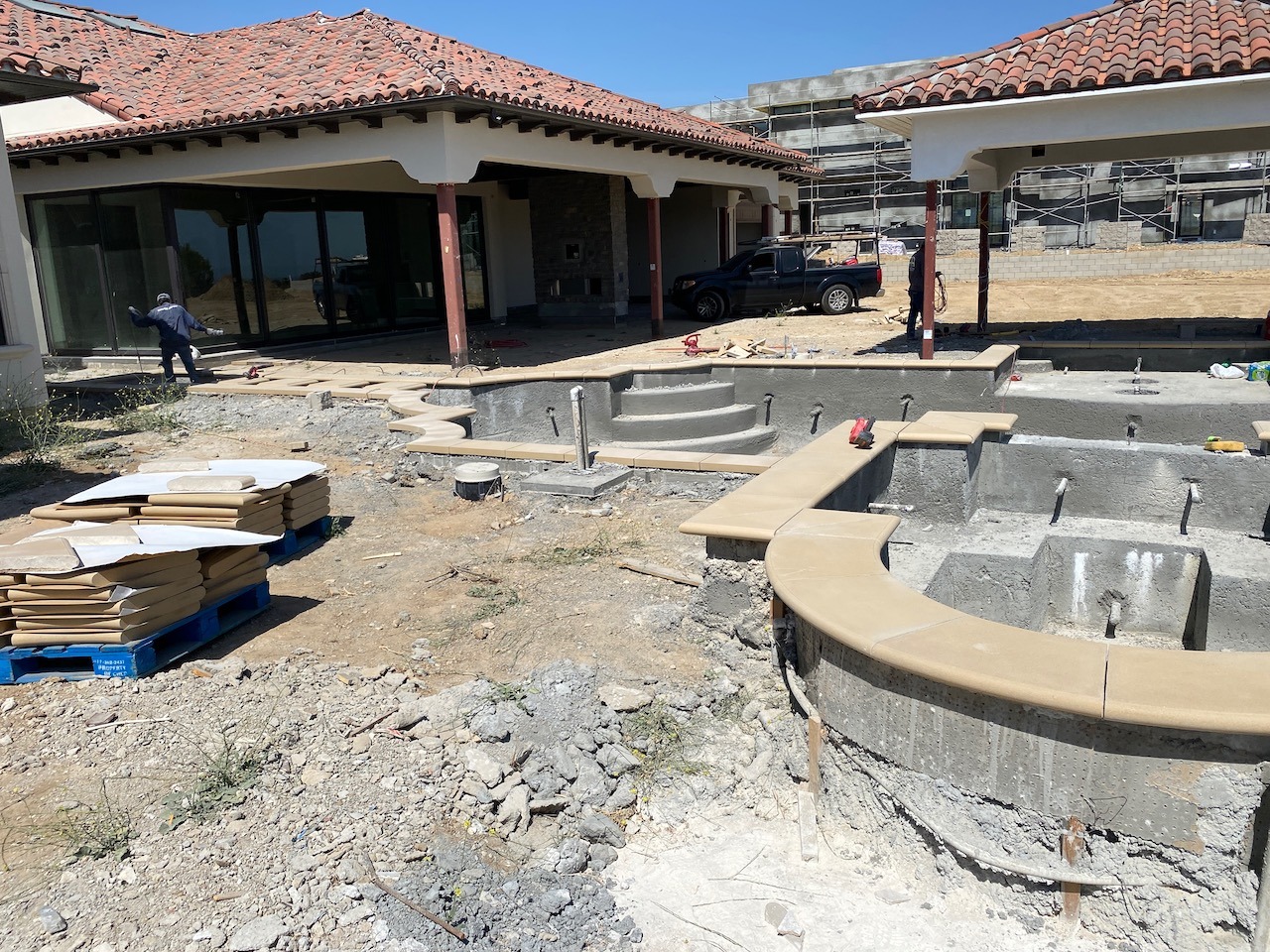

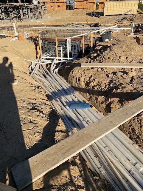

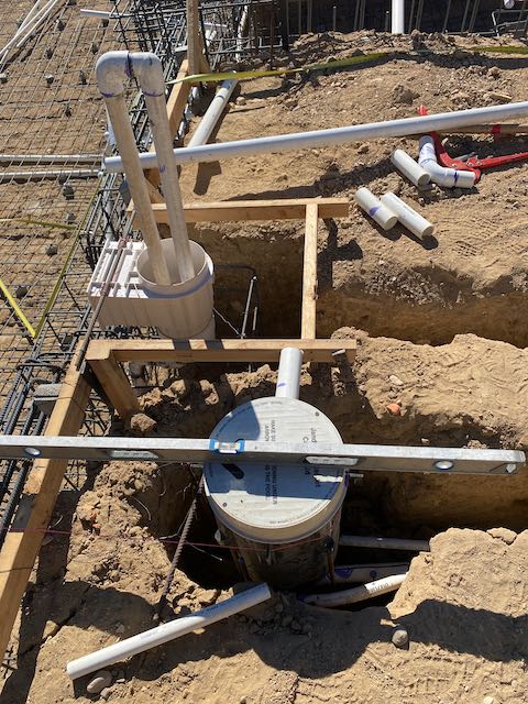

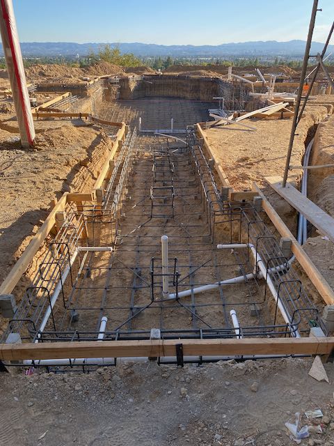

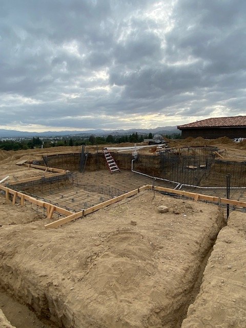

Building a house and the pool with it. GC is subbing out the pool as he does with most of the homes he builds. Pool was designed by the landscape architect. The subs are knowledgable, but looking forward to getting insight from this wonderful forum. (Already have, in a separate thread I posted about lighting.) Maybe even help others in the process.
Pool is 20x50 with an ~9x9 spa on one side and an 8x10 baja shelf on the other. 3.5' deep on each end with 5' deep in the middle. Approx 32k gallons per the calculator.
There is also a rill that flows into the pool with stepping stones for getting across. There will be a lighted fountain at the far (non-pool) end of the rill. 5-6 laminars around the pool, and 2 bubblers in the baja shelf. Also will get a solar heating system. Likely the pool will be SWG. Equipment likely will be Jandy.
Dig started last week and they are moving pretty quickly. Posting the plan and today's photos. I have earlier ones but unless someone thinks they'll be helpful I'll skip posting those.

What an awesome pool. Can't wait to see the finished product.
What part of SoCal? I grew up out there in the Mojave desert.
Wow. Just the views from your yard/house/pool! Great looking pool and you're lucky to have such progress. So many have delays of one sort or another. By the way, love your red tile roof! Keep us posted!
I rilly like this pool. The plumbing gives me a headache but I'll get over it. I expect you will have well above average need for muriatic acid, depending on how much have the various water features running. But that's just a cost (minor money, more testing and remembering to had MA) of doing business for a cool setup.

Thanks!
LOVE IT! Will there be water in the rill? I can't say I have heard that word before. Going to have to look it up.
Yup. Two supply lines that feed the rill that will flow into the pool.

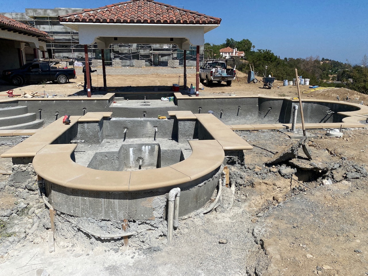

SWEET!!! That looks great! Have you started bonding with it yet? aka watering it to help slow down the curing.

Yes started watering Thursday (day after shotcrete), 3x per day through Sunday at least. I'll have to read up on those links, but do they apply to a Pebble Tec surface? Suppose I can find out myself....

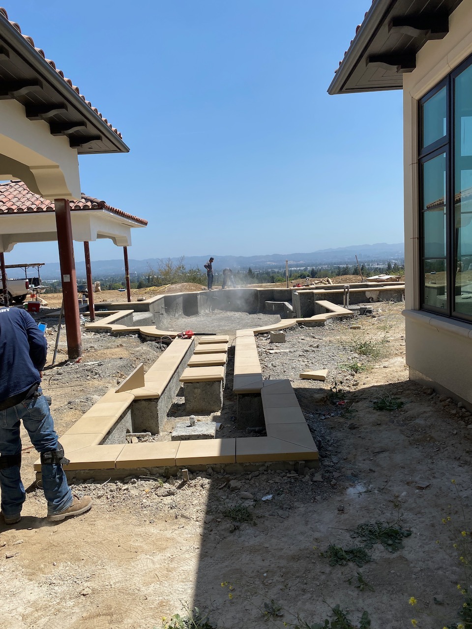

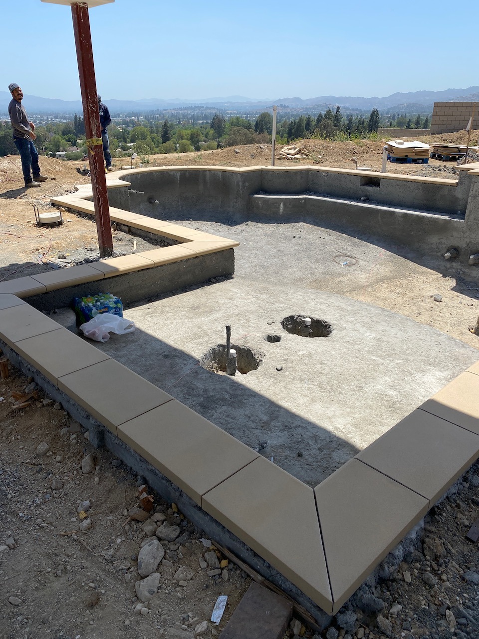

We're getting close to finishing and I'm looking for suggestions for a water feature to go on top of the pad in the rill(first pic below). Obviously a tall pot is one option, but looking for other things people have done or seen. The pad is around 17.5" square and has a pipe for water flow (should have been centered, but, oh well). There will be LED lights in the rill lighting up the water feature.
Any suggestions?
