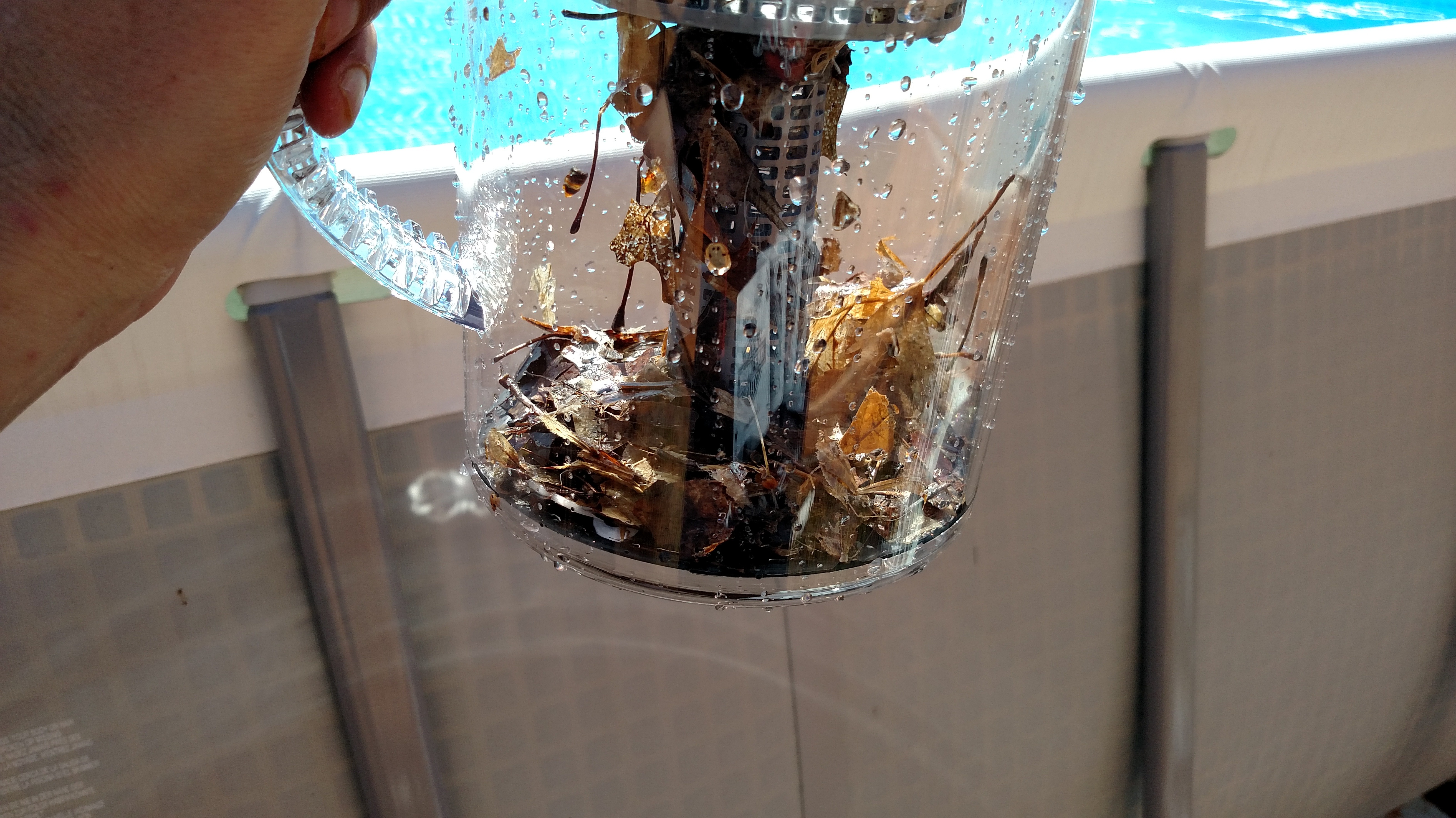

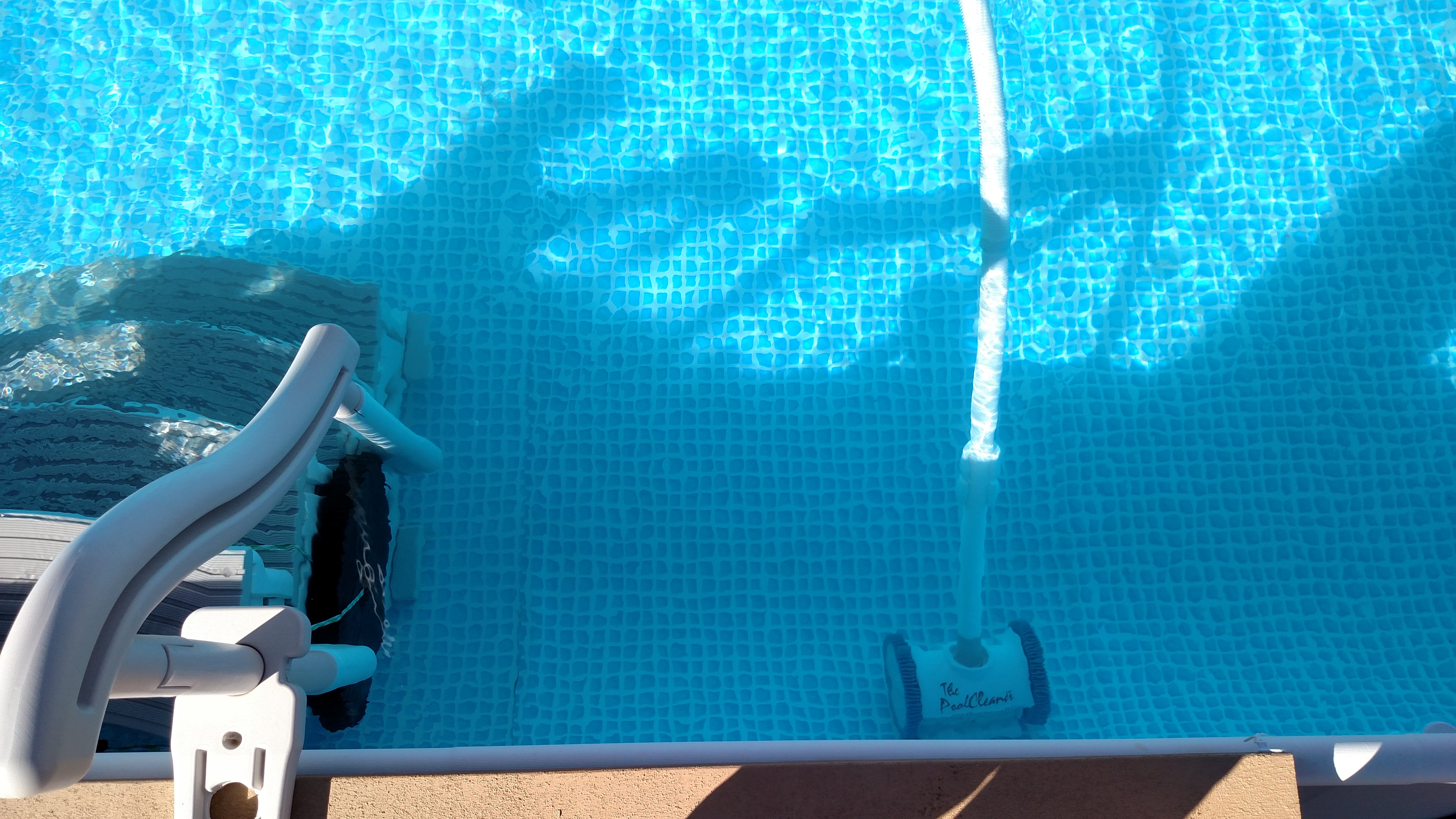

A 1.5 is powerful, I love a 2 speed or a VS for this exact reason.. You can add another skimmer or another intake, I did a vacuum port and it works great... You can use these fittings and also replace your fitting if you want... You can also get another eyeball but not sure the type of fitting you have..
This is the union to hard pipe fitting that works great, been working in mine for 8 years now.. This will also go in the skimmer if you want a union.. It may also work in your pump but make sure it is a 1.5 inch or 2 inch
This is the 2 inch hard pipe Amazon.com : Praher Union 1-1-2in. MPT x 2in. Slip High Temp 216-906 : Garden & Outdoor
this is the 1.5 inch hard pipe Amazon.com: Custom Molded Products 1.5In Mipx1.5In S Long Union S-S(High-Temp): Garden & Outdoor
Also this cleaner has worked flawless for 7 years, I had to rebuild 2 of the gears last year because it got snagged on a rope I had in the pool.. https://smile.amazon.com/Hayward-W3PVS20JST-Poolvergnuegen-Cleaner-Automatic/dp/B07SS4G8XN
This should get you going...

Hi,
Noticed your pool ladder in the pic. Do you happen to remember the brand?
Thanks
Yeah, my current single speed 3/4 HP gives me great circulation, so for my new 2 speed I went with 1HP.
I have the Confer entry system, stairs on both sides, and I made the mistake of using sand. Here is the inside when I pulled them to use them in my new pool, and this is after hours of cleaning them. I finally got them cleaned out using gallons of bleach and a strong hose jet, but I was literally gagging at what came out. So I am preaching - NEVER USE SAND!!
I drilled a bunch of holes and threw them in. I haven’t done weights yet, so they do move a bit, but are surprisingly useable just allowing water to fill them. I have my return eyeball pointed at them.
