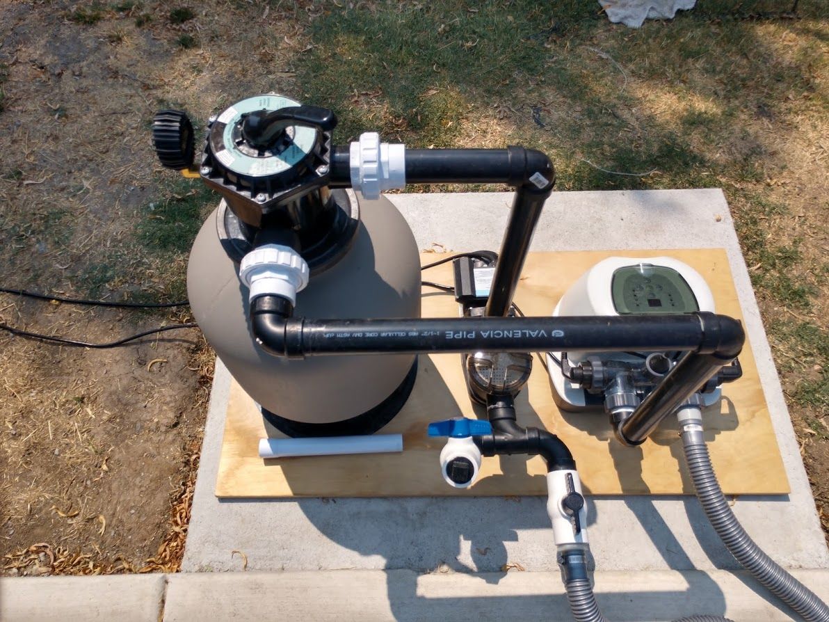

Hi new here just did 16in sand filter & 3/4hp pump conversion with INTEX ECO-5110 salt system on my summer waves 17X52 pool and kept the spaghetti plumbing down to a minimum. Just did some research on youtube lots of spaghetti plumbing on there :uhh:. By the way Here some pictures of my setup.
