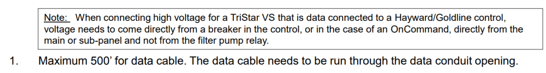

So the black and yellow wire on the remote controller are the same as the comm links on the pump? If not I’d be basically tying the remote controller directly to the pump with the connection being the terminal block thet is also connected to ??? On the board
Black and yellow are for communications.
You wire it as shown on the previously posted picture.
You can have multiple devices on a single communication terminal.
Red 1 and Green 4 are for powering a remote device like a controller that does not have its own power supply.
Since the pump has its own power, it does not use/need the Red 1 or Green 4 terminal.
