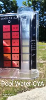

Your first order of business needs to be lowering the CYA. There's no sense trying to adjust anything else when water needs to be exchanged. So I would first exchange enough water to get the CYA down around 50 if you can. This may take more than one water exchange effort. Even if you stop with a CYA of 70, that's somewhat manageable, but over 100 no way.
Start with the CYA first then come back and post new test results and we'll give you a good get-well plan ahead. Enjoy the weekend. :swim:

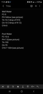

Did you see how high it was on the test kit. OMG it's at the very bottom. Probably 200+ They were using Trichlor and Dichlor and no test kit. Just thinking clear water is ok. Those both raise CYA and IDK how long they been doing it.
Yes, very common for newbies who arrive at TFP after years of pool store advice. I suspect it will take several water exchanges to finally see movement in the CYA test, but you'll get it.

So I just did a High CYA test. Filled to 7 added bottled water to 14. Drained off to 7 and added fresh water again. Drained to 7 and added R13 ro 14 and the result was 80. So I multiply x 4 due to I diluted once which made 50% pool water. Then I diluted that which made it 25% correct? So at 25% pool water the CYA is 80 so 80x 4 which I 320. I already Drained and refilled 12 inches of water also. Going to drain now to 12 inches above the shallow end and refill.
Oh yes, I'm afraid you're going to need to exchange much more. You have a good sized pool. You can take it lower than 12" at a time if you wish. As long as you leave plenty of water remaining to keep the liner pressed-in tightly it should be fine. But go with what feels comfortable to you.
