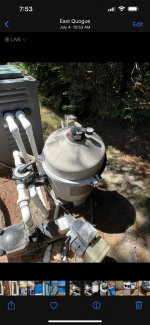

I have a vacation home. I do not live there M-F. I have a friend who helps me keep the pool balanced by adding chlorine tabs and shocking when necessary. I don’t want him to have to do to much as I’m sure it’s a pain for him. I balance the pool and top up chlorine Sunday evening before we leave. He comes Wednesday and Friday to check and add.
I would really like to install a reliable bullet proof system to :
Allow me to monitor FC levels and adjust a swg over Wi-Fi.
I have a single speed pump what the advantage of going to a VS pump ?
Added bonus would be If I could monitor PH,TA, CH ,Cya
Thanks for the recommendations. All my current equipment is listed in my signature.
If you have a set you your recommending please let me know how long you have had it, any issues and how you solved them, how the manufacture has been in terms of helo if needed or tech support, what your regular Maintence was and if you don’t mind the hardware cost and install labor cost.
I’m a diy guy but electrical and plumping are not my strengths.
Thanks
