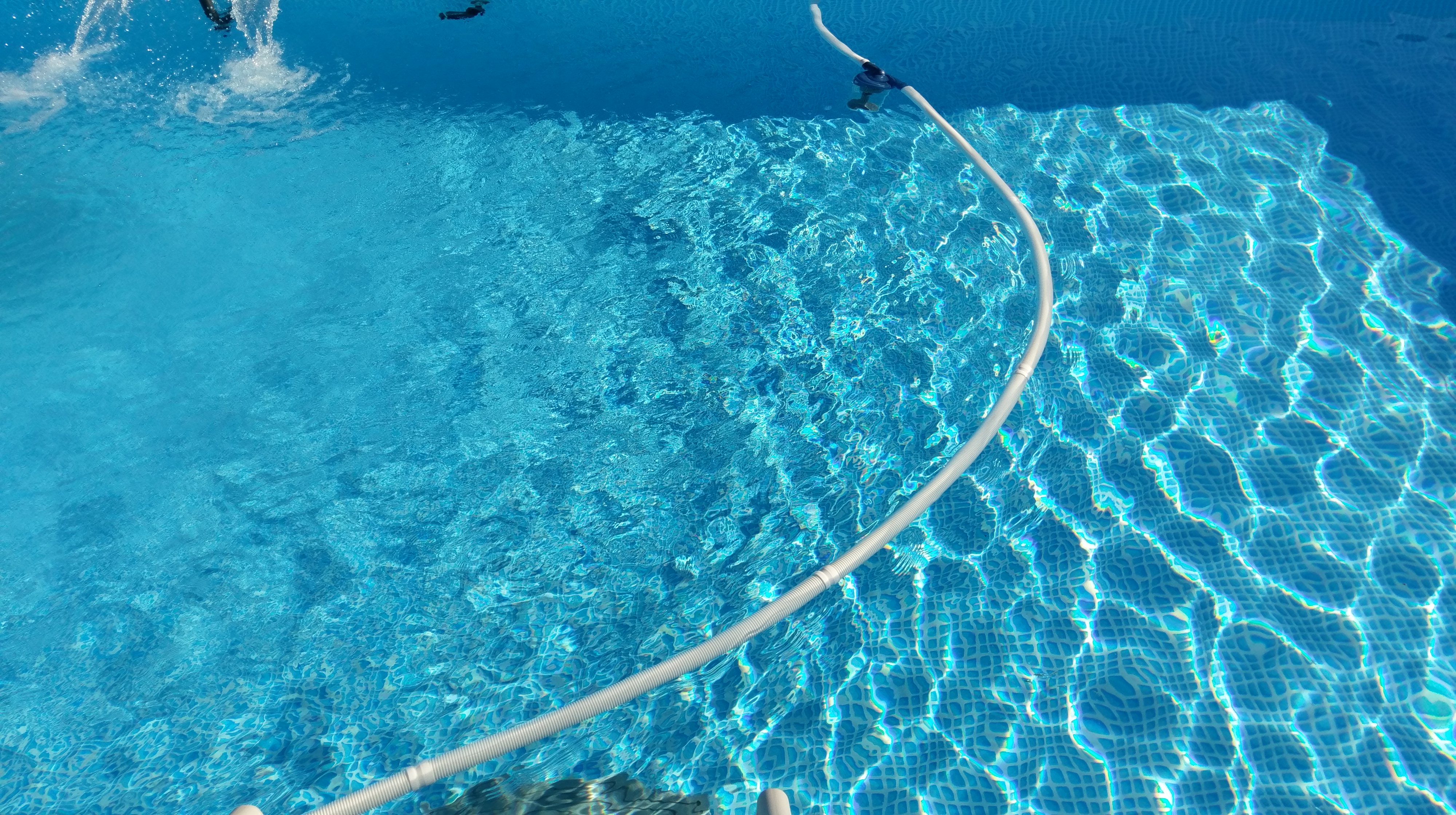

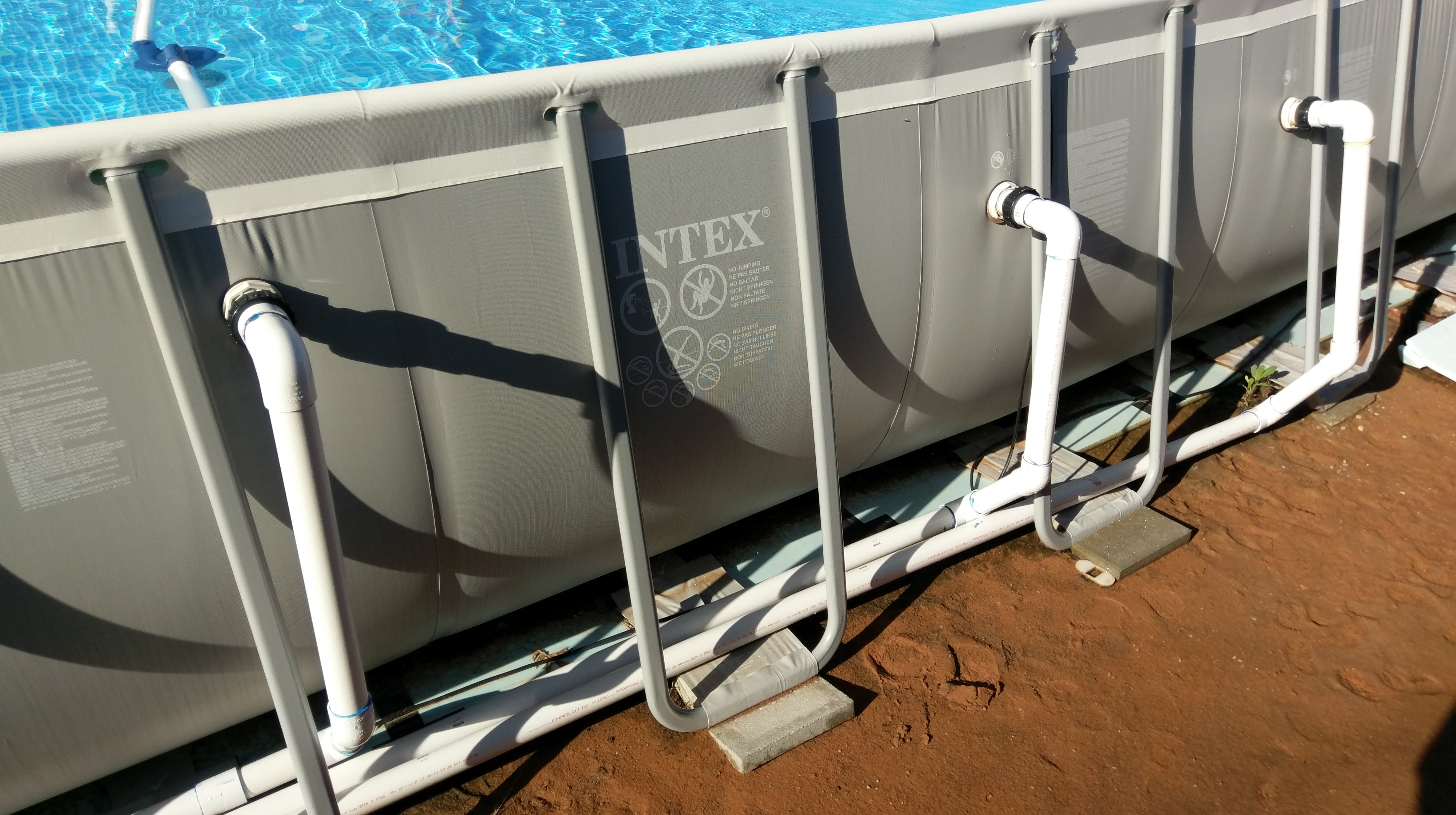

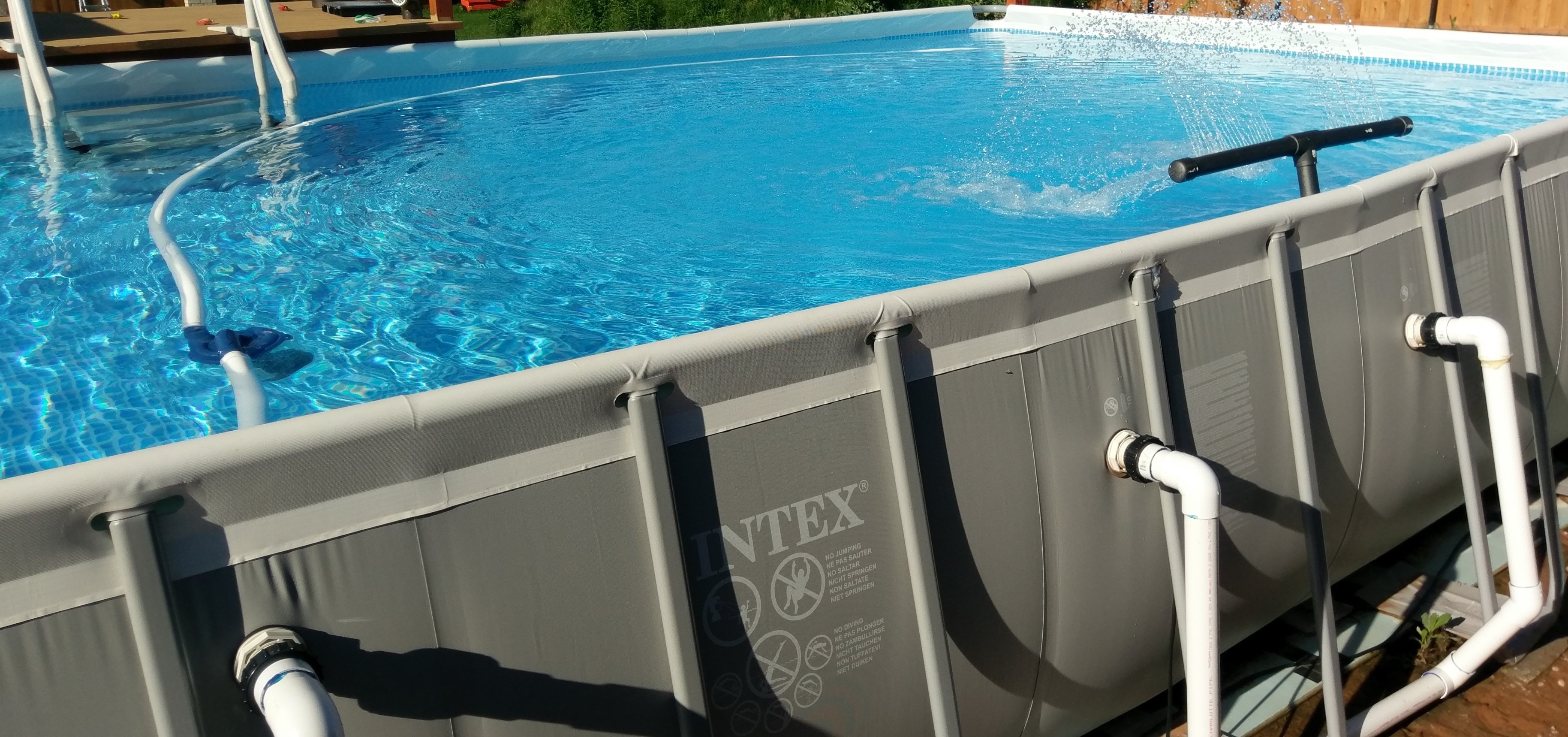

You got a nice filter there, sand correct? I would use that one in a heartbeat and get a 1 hp pump..
To connect to the pool with 1.5 inch pipe is easy.. I did a skimmer and suction side cleaner and 2 returns...
Use these to connect to the pool and slip pipe on the outside, it will also fit the skimmer and depending on the pump you get they will fit it also.. mine have been leak free for 9 years... :)
