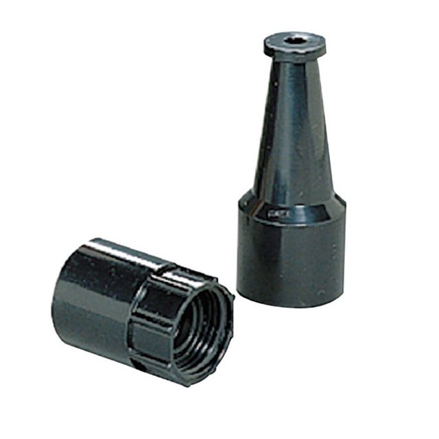

I just recently finished up a landscaping project where I had to tunnel under a sidewalk and it hit me that the tool I used would be perfect for this. Pic is attached it's like $5 for the kit then I think it's 1" pvc glued between the two pieces.
So I hooked it up to the hose and went after it, being very careful around the laterals. Long story short the water flowed out dark brown for about 10 minutes I felt several chunks break up down around the bottom. And this is after I ran just the hose for like 30 mins. As soon as the water cleared I buttoned it back up and the filter has never worked better.
