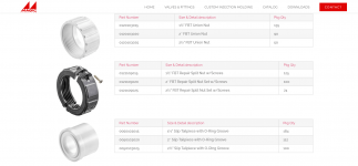

The coupling cracked in two. It's the lower white one in the picture. I suppose that the curved pipe is part of the valve body and I have to replace the whole thing?
Is there any type repair device that can clamp on to the threads to hold it tight?
Any other repair options?

Maybe one of these will work.
I ordered a couple of these the other day when I saw your first post. I'm not sure if it's any larger than the ones in the store. I tried to measure the nut, but it's hard to get to since I put it all back together so I can at least get circulation. It looks to be close to 4" OD. Maybe a little less.
The valve is a Praher SM20-2 going into a Jandy DE filter. I was ready to just get a new valve, but the equivalent they had in the store didn't line up with the bulkhead fittings. Do you know where I can get a new Praher valve?

Looks like I've been looking in the wrong place for this valve and using the manufacturer instead of the brand.
This one looks to be it. The nut is 3.25 and span from bulkhead is 8, which seems to match mine.
