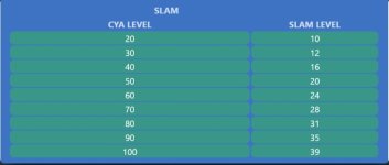

You must know your cya/stabilizer level to properly chlorinate as you can see in the charts I posted above.

While the addition of cya (if you truly currently have zero) will help with the sun consuming your chlorine it won’t do anything about the algae.
For that you need to do the
SLAM Process with liquid chlorine.
To do that accurately & efficiently (in terms of time, energy & expense)
you really do need the fas/dpd test as it tests higher fc levels accurately unlike strips or the yellow OTO drop test.
Otherwise you are truly flying blind.
It is not a one time addition of chlorine- it is MAINTAINING slam level fc for your cya until you pass ALL 3 end of slam criteria as listed in the article.
FC/CYA Levels
Your swcg is not capable of overcoming an algae problem- they are simply designed to maintain normal daily fc losses in the 2-5ppm range.
