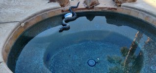

This is my first check when it is daylight. Everything still seems to be running fine being left as it was for pool return, except the spa drained quite a bit. This was the same reason I called the tech out originally. Is this nornal? I was told with new check valves it would stay where it was.

Im assuming you mentioned calibration of the actuator because the spa isn't getting flow anymore unless it is on Spa mode, so I am going to have to let that valve be open a little. Before doing that I still want to figure out the caretaker, as it would seem my spillway wouldn't automatically work in the current set up, am I guessing correct?IMG_20220107_081920.jpg
Correct, your spa bypass is on the IFCS return. You would need to calibrate the pool/spa return valve actuator to divert flow to spa if you were to keep the IFCS closed.
Since the spa isn’t getting filled back up, noticing small water loss in the spa will be more noticeable. It could be a number of things wind, intake pool spa valve, jet schedule, failed new jandy valve.
It does seem like a coincidence but there is nothing im seeing that makes me think replacing the jandy check valves caused the issue, unless they were installed backwards. From the pictures it doesn’t appear so.
