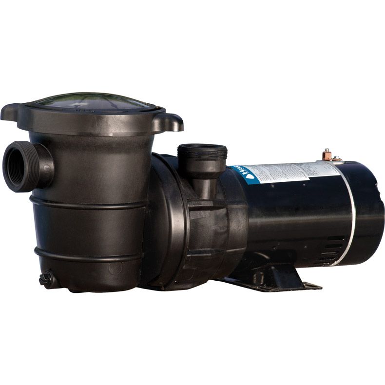

Hate to say but my "new" intex pump was dead after only 1 season- I''ve had them along the way since having AGP's last 10 years but they've usually lasted 5+years. When I took Intex Pump to have checked, all said was "it's junk" and it was the second one he'd seen that day. I did call Intex re: warranty but got recording that they were not accepting calls. After researching and deciding not to replace with Intex pump, I bought a Harris 3/4hp pump:
It is by far, the best ever. I did use same intex sand filter and also purchased the Game brand connectors and a "T" connecter to adapt plumbing.
