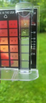

Good evening guys, I'm new to the forum and fairly new to the pool world. 4th year with an 15' Intex above ground pool. Up until this year I've had zero problems with my pool. Upon uncovering pool water was green unlike previous years. I have been trying for a little over a week in getting the water clear but haven't had any luck. I have managed to get the water to a light blue ocean colored type water but it is very cloudy and can not see the bottom. I have shocked it twice now and still not clear and a little lost on what to do now. So here is my test results from a Taylor k-2005 salt test kit:
FC: 1-2ppm
TC: 3-6ppm
CC: 1-2ppm
pH: 7.8
TA: 120ppm
CH: 110ppm
CA: 100ppm
SALT: 3200ppm
BR: 2-4ppm
My pool holds 4440 gallons of water. I run an Intex Sand filter system 1600gph along with an Intex Krystal Clear Saltwater generator (not turned on at the moment). The pool also has the Intex skimmer and a sprayer fountain. I've had some people tell me I needed to raise my chlorine levels up higher to really shock pool until it clears up. So that's why I'm here. Can someone please help me with what I need to do? Thanks guys

You will need an fas dpd test kit for that. Your k2005 is missing this.
Or Taylor https://www.google.com/aclk?sa=L&ai...p9qWkZ-NAxW0SzABHd5VAB8Qwg8oAHoECAYQDQ&adurl=
If your cya is reading over 90 then you need to do the diluted test (see step 8)
To confirm your true cya so you can replace the appropriate amount of water as doing the slam process with cya over 70 or so takes alot of chlorine which isn’t cheap. Ideally it would be better at 30-50ppm for slam.
See —> FC/CYA Levels
Until you have that fas dpd kit and can slam properly just add 5ppm worth of liquid chlorine each day to keep things from getting worse.
Use PoolMath to calculate
