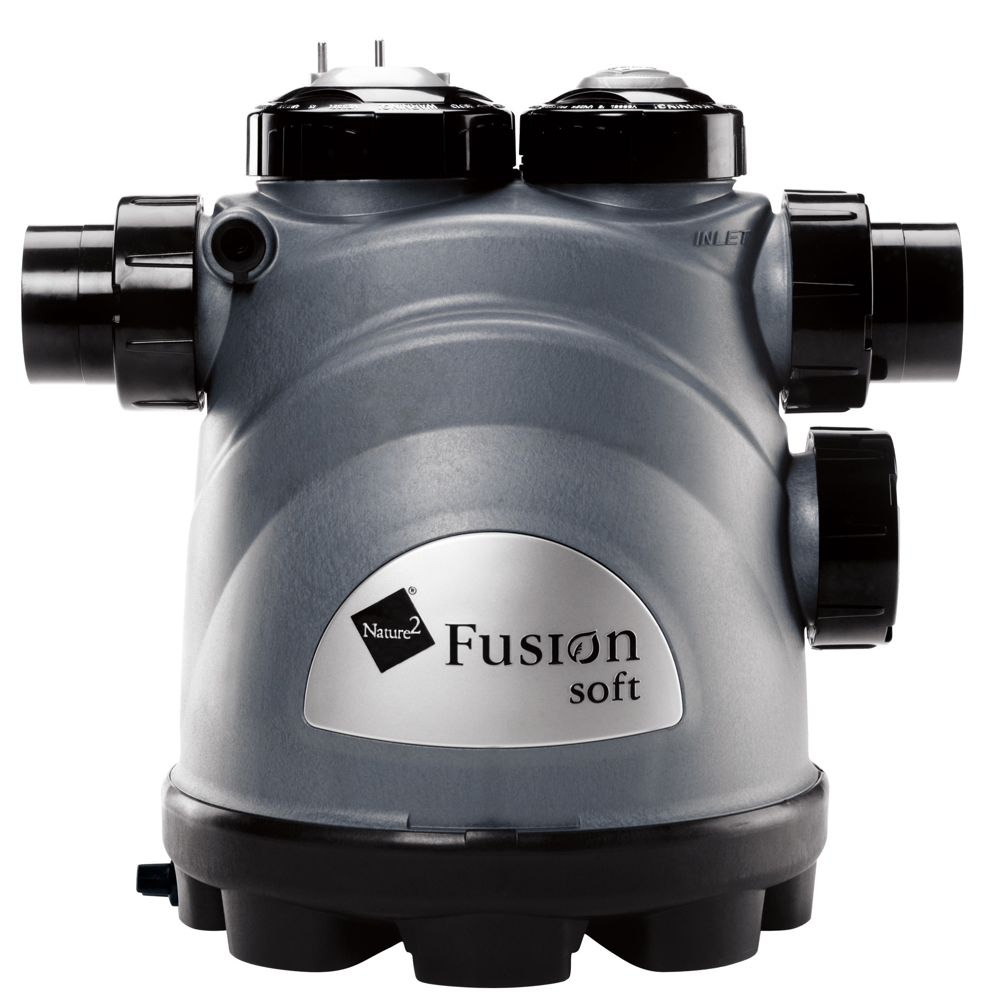

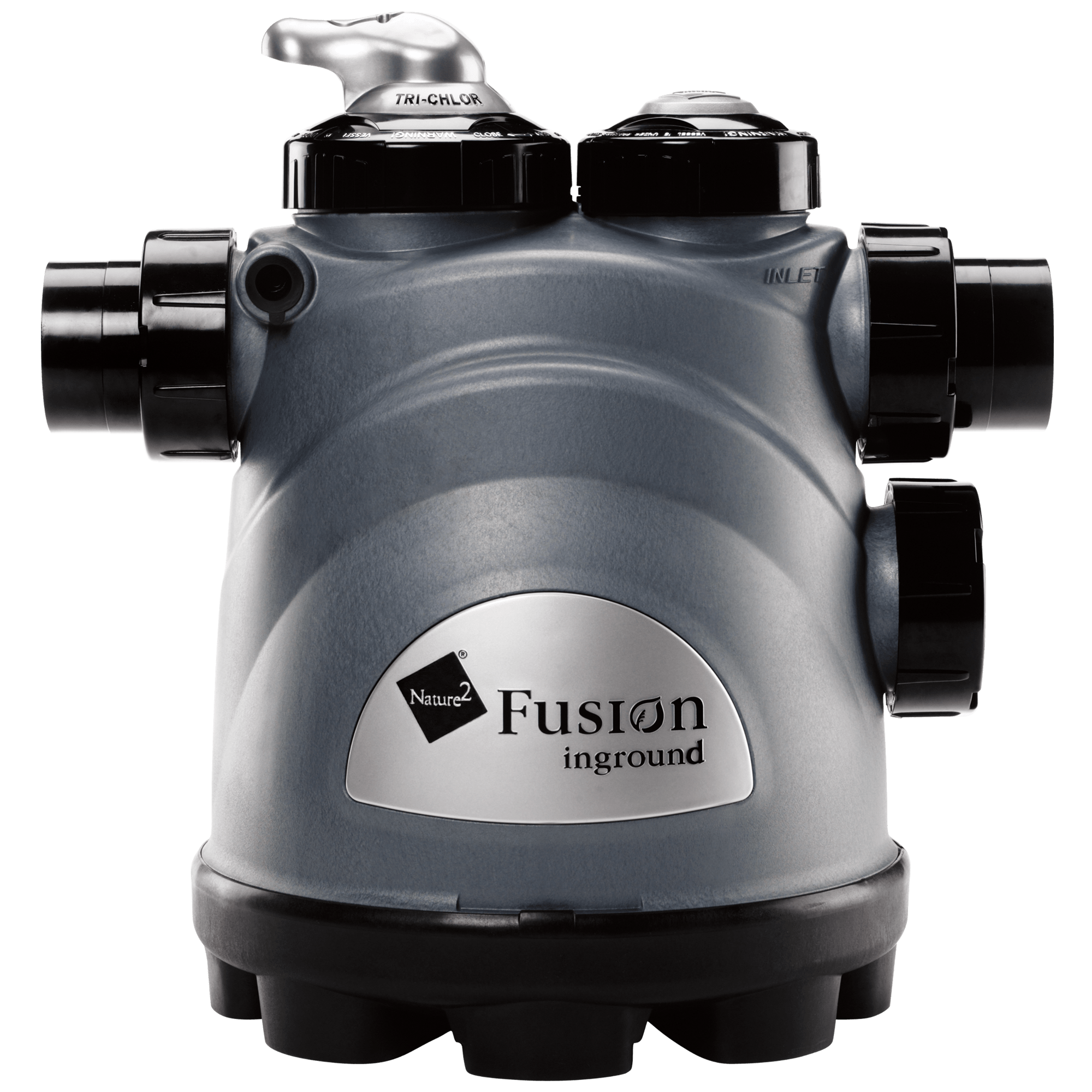

My first question is whether I really need to change the vessel at all. Does anyone here know if the 2 vessels are the same, and I can just get the salt cell
I have the FusionSoft and I am not sure it is the same vessel. It has a hole right under the input water for the flow and temp connections that the cell require. On top is the mineral cartridge and then the salt cell. Even if the vessel was identical, you'd have to basically get an actual fusionsoft anyway for all of the components that the salt cell requires. The biggest advantage I see if they are the same is an easy swap. I have no issues at all with the fusionsoft but I have never used the mineral cartridge ever. As a salt cell it more than handles my pool. It fully integrates into the iAqualink as well.
Looking at the pics side by side they do look identical! Are you Rockville, MD?
Thanks for the response. You're right, I forgot about the sensors on that lower port. So I guess it makes sense to just get the whole system together. Although prices I see online are still much less than what the PB is quoting me for the parts.
