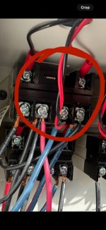

this is the relay
is this the power your refering to?
thanks for your reply
That relay looks like all the devices are powered from the LOAD side which is incorrect if one of them is a VS pump.
In addition I see 3 wires under one LOAD screw and 2 wires under the other LOAD screw. What are the 3 devices being powered?
That wiring is sloppy with a mix of stranded and solid wires.
Is the pump on a GFCI CB as required by code?
You can power the pump directly from the breaker so that it has continuous power.
The pump is controlled by the communication wires, not by a relay turning the power on and off.

which are the line screws?
