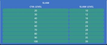

Mdragger88, have I lost my mind? I swear I saw a blue and purple CYA level chart here somewhere just a few days ago, but now I can't find it.
Maybe it is on another website....
