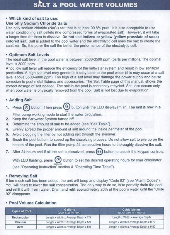

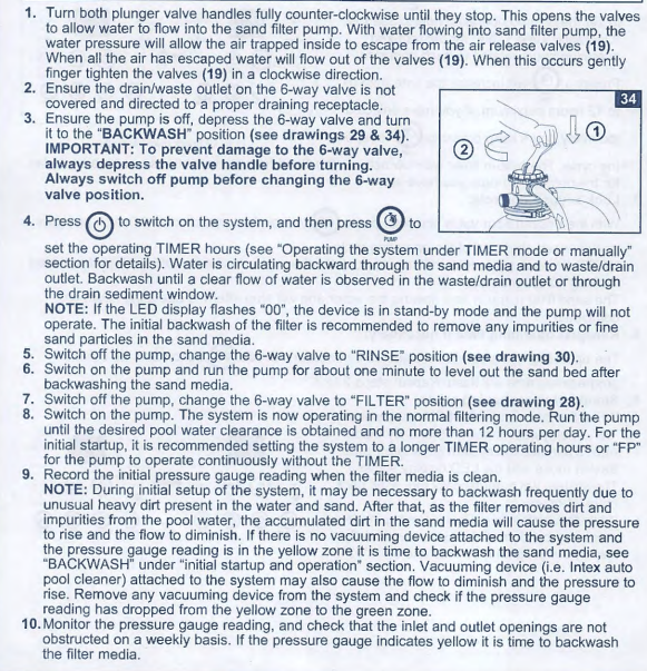

I have the Intex saltwater system Model ECO15110-2. We have already backwashed for the first time and it’s now on 01 on the led screen and the 6-way is turned to filter and it’s currently working fine. However, it says to put the pump into FP mode while we add the salt to the pool.
The problem being that it never goes out of 01 no matter how many times I push the pump button. According to the manual it says to keep pressing the pump button until FP displays. I have tried
but all above still just displayed 01.
Am I missing a step here?
Waiting 5 minutes after turning off the pump
Holding the pump button down while it’s on for a minute.
Completely disconnecting it from power for 5 minutes
