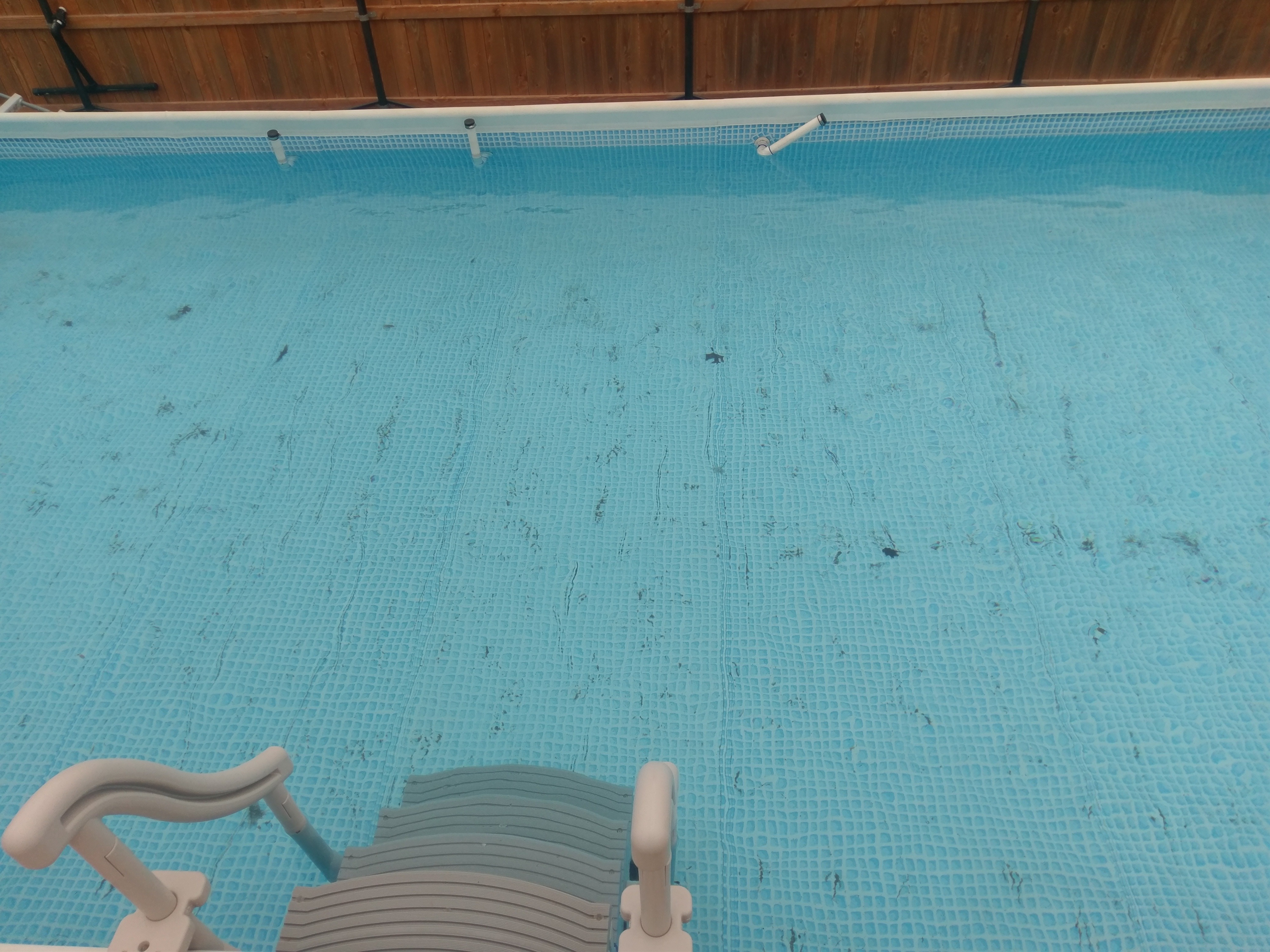

Attached is the deck so its more clear. @cowboycasey that was my concern. I do get some leaves but not a lot and my neighbors have cut back some trees which is even better but as you can see there are still some.
I would consider leaving the pool full and plugging the skimmer and returns but I admittedly am a little afraid since this is an intex pool although it has hard plumbing and hayward skimmers?

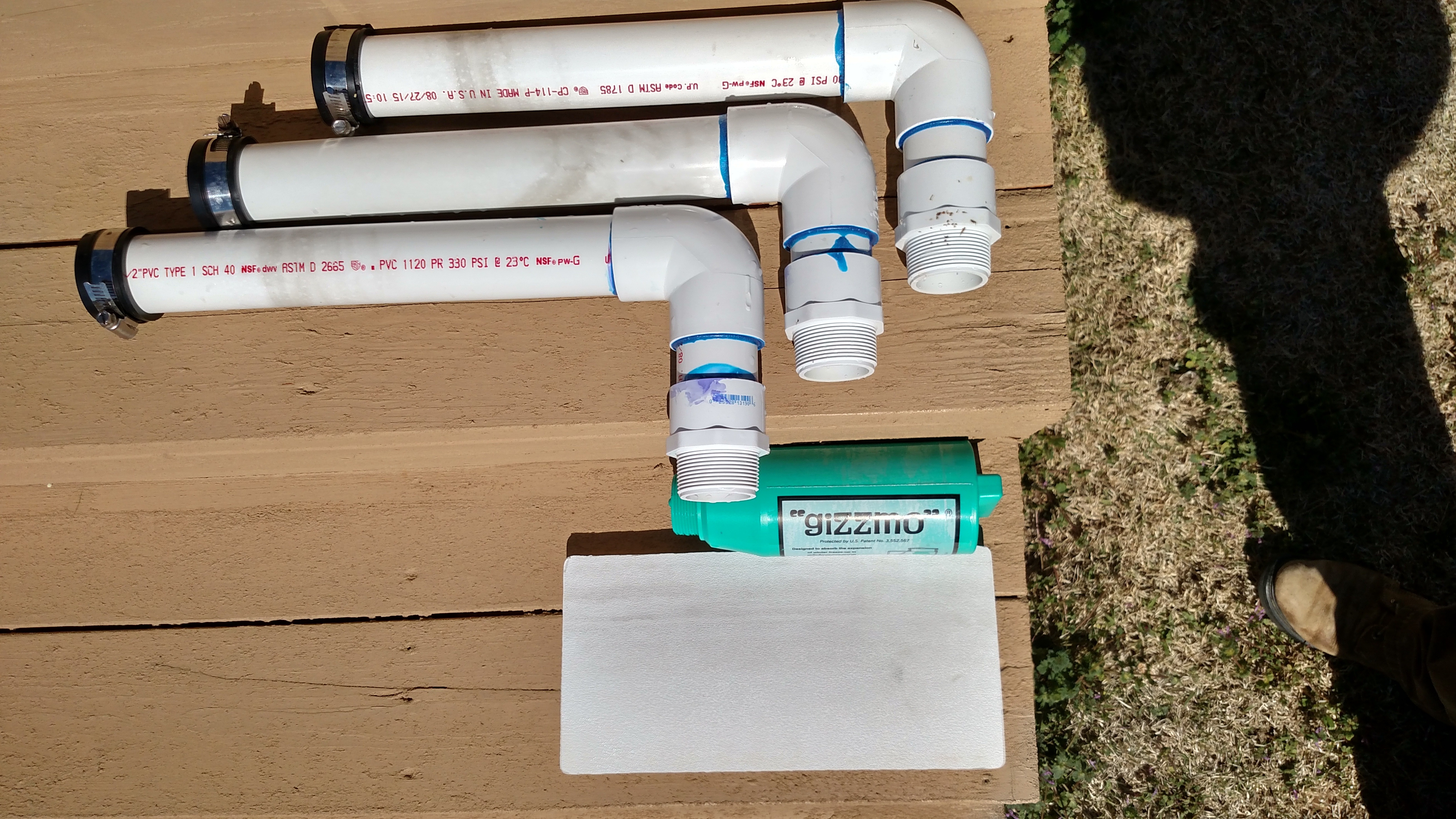

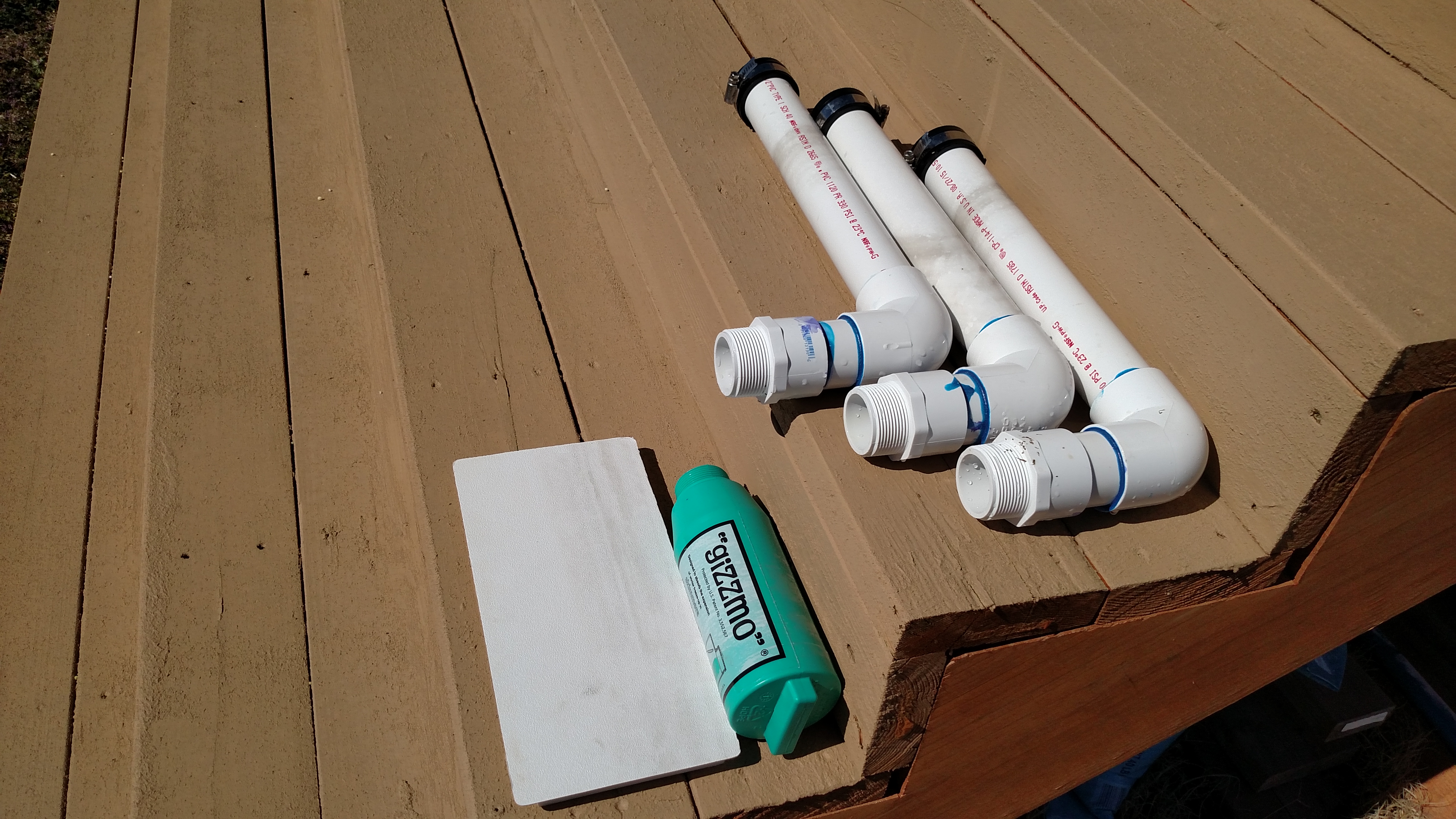

I have left mine full for 8 years it will be just fine if you winterize it and blow out the lines.. You can do it 2 ways..
1. use this bungee plug in the skimmer and returns and blow out the system from the pump side.. Amazon.com : Aqua Group Aqua Products Plug for 1.5 Inch Lines BP15 : Tools & Home Improvement
2. use 1.5 inch threaded to slip with about 18 inch pipe and screw into the returns and then use a Gizmo Amazon.com : Gizzmo MWUG Ultra Skimmer Freeze Protection with Blowout Valve, 16- Inch : Swimming Pool Skimmers : Patio, Lawn & Garden
You can see them below, this gives you the ability to blow them out from the pool side and leave it full :)
