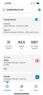

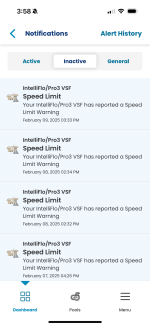

I saw a post on this before, but still cant quite figure out my problem. I have been running my pump on 20GPM pver the winter. The basket never fills to the top. I just assmued that was due to low GPM. I went to change the settings to my usually daily run time of 8 hours at 61GPM and I keep getting these Speed Limit Warnings.
Previous recommendations on previous post mentioned to check the filter, joints in the lines, etc. So, I cleaned the cartidges yesterday, and checked the SWG cell for any debris. There was no debirs present in the SWG cell. I cannot find any leaks either. Everything seems to be running as normal with the low GPM setting, but the pump cannot raise above 21 GPM, even when running near 100% speed.
Here are screenshots of the app while running these programs.
I hope I have explained this well. Please, let me know your thoughts. Thanks!
