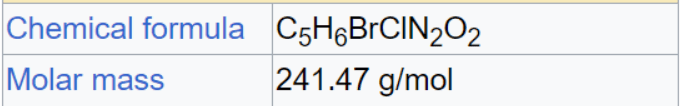

C5H8N2O2 (DMH).
CAS Number: 77-71-4
Molecular Weight: 128.13
128.13/241.47 = 53.06% DMH.
If you use tabs, 20 lbs of tabs will add 10.612 lb of DMH, which is 63 ppm DMH and 50 ppm of sodium bromide.
To remove 10 ppm of DMH, you need to remove 3,175 gallons and add fresh water.

C5H6BrClN2O2 + 2H+ + 3Br- --> C5H8N2O2 + Cl- + 2Br2.
One mole of BCDMH provides 1 mole of DMH, 1 mole of bromide (after reduction) and 1 mole of chloride.
It also provides 2 moles of bromine (Br2) based on how bromine is reported.
2 moles of Br2 = 319.616 grams, which is why the percentage of available bromine is higher than 100% of the mass of BCDMH.
319.616/285.923 = 111%.
1 mole of DBDMH or 1 mole of BCDMH provides 2 moles of Br2.
20 lbs of tabs will add 26.47 lb of bromine, which is 158 ppm bromine.
