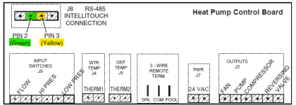

I was having trouble getting the heater to come on line when called for via the intellicenter app. I would call for heat to pool, it would come on but only up to set point on the panel, not what I dialed in on the app. So I would raise the set point on the pad and then It would go up appropriately. Not making sense I tooth panels off both the load center and the heater, and it appears that the installer only hooked it up using the 2 wire fireman switch (blue box), and not the Rs-485, which is why I'm guessing it won't adjust from the app to the pad without me physically changing the heater pad? posting some pictures, of the panel. Should I call the electrician to come back and fix this or handle myself, I can certainly do it, not sure if I Should? Should be in connected to the yellow box or green box (connections goes to SWG board)
Next thing is the heat pump, when selecting heat pump only my heat pump does not appear to be kicking on to heat, is there a temperature delta that needs be in place for it to attempt to heat? My thought was we hated using the gas heater then use the heat pump to maintain it for a few days, weather here has been in the 40-60s during the day, water temp is mid 70s currently after being warmed, before that was around 52. It does appear to be in Rs485 connection via the brown wire to the connector in the yellow box. Am I being to impatient ?
