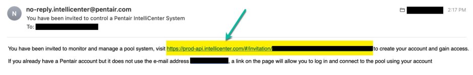

4. Once you click the CREATE box, your guest user will receive an email similar to the screen capture shown below. Once your user receives the email, they need to click on the hyperlink as highlighted below.
