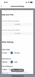

If it’s connected to WiFi or internet set the date and time to the Auto function so that it pulls it from the net (as it knows your locations) then it always resets after each outage…. Under advanced settings clock source = Auto
