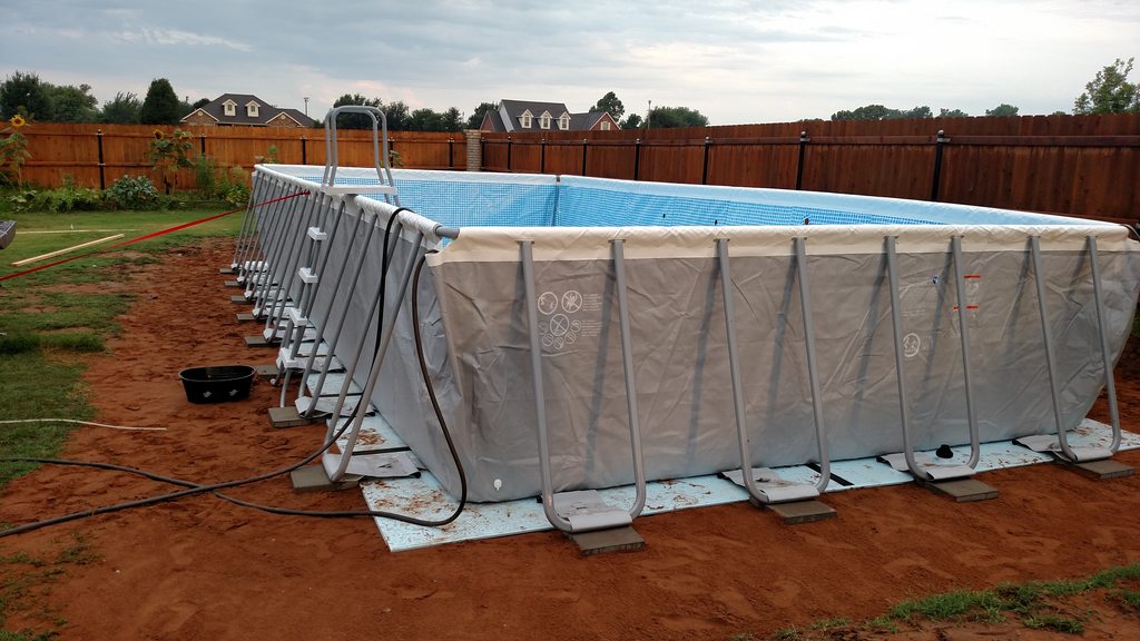

The TFP forum has been a great resource so far. I am in the process of leveling off my 30' pool area and finishing building a retaining wall because I learned to remove height to match the lowest spot rather than build up would have the best results. My soil here is sandy with no rocks so it has been pretty good so far. We are planning to put down 2" of Foamular 250 (25psi) extruded polystyrene pink rigid foam as the bottom of our pool and I wanted to seek the expertise of others who have done this.
Another pool owner suggested to use 4" solid 8"x16" concrete blocks for my 20 upright posts rather than thin pavers so you had more surface area to hit with the posts's plastic foot plates. Does that make sense?
I assume I would set the top surface of the block even with the top of my foam. This would mean I sink the 4" block in about 2" and lay the foam right on the level surface, correct?
My next question is where should the 2" foam stop? Can the foam run out under the plastic bottom rails running from post to post or should the foam be kept short of the pool wall? I believe the weight of the pool wall is being held up by both the posts and that bottom rail. Given the weight of all of the water, I assume the foam will compress some which would make me think the foam will also compress below the bottom rail but would not be able to compress the concrete block. Is that an issue or is the weight held by the posts and not really the bottom rail?
I believe I read I need to Gorilla duct tape all of the seams of the foam after fitting them tightly. I assume this is still the best duct tape product to use?
I plan on using foam pool cove. Do I duct tape those end seams as well? How about the foam pool cove to the pool wall or foam pool cove to the foam floor?
I appreciate in advance the help!!!:cool:

Hey there, great questions..
1. the 4 inch solid blocks will work better, I know because I did not use them and some of mine broke in half...
2. I used 3/4 in foam and works great, is there a reason you want 2 inch, it adds 20 buck per sheet...
3. Gorilla tape is great, the 3 inch extra wide is what I used
4. I took the foam to the edge of the blocks, some have cut out the foam over the blocks.. its better to have the legs in direct contact with the blocks
5. you would dig down to put the blocks even with the bottom of the pool/foam
I hope this helps :)
When I did ours I set the pavers flush with the top of the soil. Then laid out the bottom rail and set the wall up. Once the wall was up we went in and laid out the foam panels and cut them to fit snug around the edge of the wall. We then triple taped all the seams with 3" gorilla tape. Then laid the foam cove on top of the foam floor and used gorilla tape at every seam and just a few strips at the top of the cove here and there to hold it down and in place as I knew once the water weighed everything down that the cove and foam floor would press down into its final resting space.

The blocks have to be flush to the ground level, large enough to cover across the entire leg width, not just partial, and the thicker the better. Also depends how thick the foam is that you used. I used 12"x12"x4" blocks for mine, 3/4" foam, and a gorilla pad. The foam should not go over the blocks as the weight of the pool will push the legs down through it and not be even all across.

You are correct Windylou, the blocks are 8x16x4 thick. These are solid concrete block and weigh 33 lbs each. They seem quite a bit more substantial than the typical thin patio block and it's size gives a little more leeway to hit.
Here is my question....for my above ground pool, the base and legs will sit on the blocks. How much weight or pressure is exhibited down by the pool on the resin frame? I am considering cutting out around the blocks and then running the foam out under these rails so the pool floor and the rails are supported by the foam and each base plate is supported by the block. I am thinking the foam could even be a little proud of the blocks (say 1/4 inch max?) holding the base plates since it could compress.
