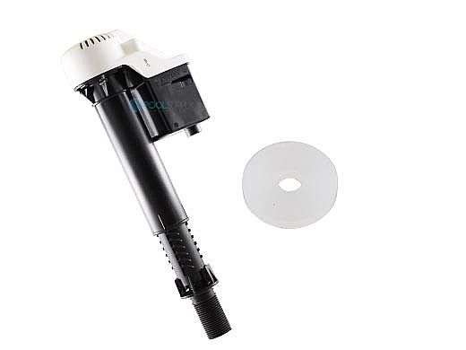

That started to misbehave, and I mentioned it to my pool guy and he replaced it (without asking me, but I know he was simply trying to help) with one of these:
Now the problem is consistency. It seems to work, the pool fills to around the expected level then over the next day or two the level drops like 1/4 or even 1/2 inch before it triggers and starts to fill again. Then it fills OK but to a slightly different level to before and I just can't get consistency or precision.
I'm on a shared well and its important that the pool fill up small amounts, incrementally, during the day rather than 100 200 or 300 gallons ever few days. So I just want the Dang thing to maintain a steady level day after day - it used to behave fine with the original filler valve by the way, I seem to recall it always was at the same level, visually it never seemed to vary at all.
