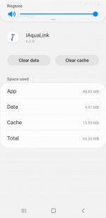

Logout of the app. Then clear the app cache and data just memory. Then start again and login. No need to reinstall. Screenshot_20220515-160604_Settings.jpg

Yeah sounds like it was bad login cache data from the app. Reinstalling frequently still uses old cache data. Gotta be a way to clear that on Apple.
