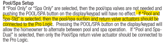

The return actuator needs to be plugged into Valve1.
The suction actuator needs to be plugged into Valve 2.
Pool and Spa - Std should be selected in Configuration.

Lower left of the board there are FOUR valve actuator sockets.
Bottom two are for RETURN and SUCTION.

Yes, that is what I am saying.
I

Valve 3 - SUCTION - goes to Valve 2
Valve 4 - RETURN - goes to Valve 1
