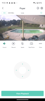

Our pool is now officially green again, I'm so ready to give up. We've started adding chlorine as of yesterday which puts us at one week from AA treatment. Considering it was green before adding chlorine I am leaning towards it being algae this time, but also since we had so much iron to begin with I am not sure if the metal out held it suspended in solution very long? We added the metal out last Wednesday and it stayed blue until Friday when it slowly started to change colors. We haven't had any particularly warm weather yet either, 50s in the evening and we've had one day in the 80s but it's been cloudy and rainy.
I've turned SWG back on to 30% and added 2 121oz containers of 7.1% bleach since yesterday. Chlorine seems to be holding on the low end, and I haven't noticed any change in water color. Before bringing to SLAM levels I did add some Polyfill to our skimmer this evening. I am going to give that a few days to see if we start to notice a color difference before trying to shock for algae, I REALLY want to avoid SLAMMING too soon after AA treatment and precipitating iron back onto our liner. Will keep the thread posted with updates.

By the pic, that water looks cloudy, implying algae. Am I right that it's cloudy.
Have you ordered a TF-100 or a Taylor 2006-c test kit? Without one of those 2 test kits, we aren't going to be able to guide you because we won't have the info needed.
Yes it's very cloudy but it became cloudy within 48 hours after the AA treatment. I have been told AA makes the water cloudy, plus we added phosphate remover which apparently adds to cloudiness as well. I don't doubt that there is algae at this point though since we went to long without chlorine. Even though we dumped polyquat in there
