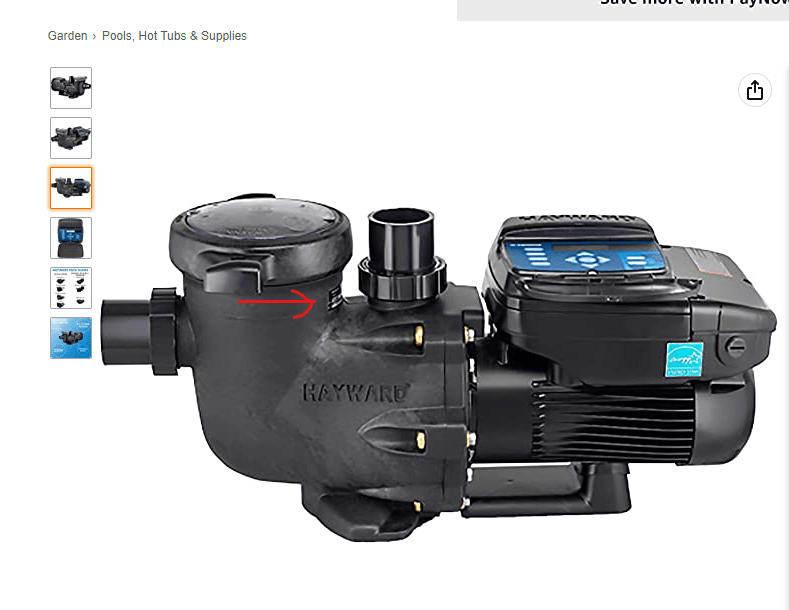

Did you happen to check the part number for the impeller when you had it apart?
It should be a SPX2710CM impeller.
Impeller for 1.5 HP Max-Rate Pump.
