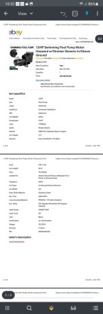

Only 2 years old. Supposedly there is a 9 yr warranty. I msged the seller. Tomorrow will replace with spare pump. Hopefully I attached the motor to the plumbing correctly. Is it a big deal if the pool has no filtration for a day or 2?
That seems a bit fishy to me. :scratch: That particular single speed Hayward Power-Flo Matrix pump looks like it has a split phase motor. I don't think you have many repair options, but let's ask @mas985 to be sure.
