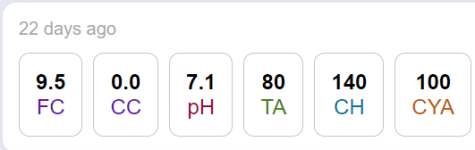

So I think I have figured out where I went wrong but I want to make sure I fix it correctly. I have had this pool for 3 years and it has always been so easy. I have always used tablets in a float to chlorinate without issue, well I must have had some without stabilizer previously so I didn’t realize the issue they can cause. This summer (on a new bucket of chlorox xtra blue, never used this brand before) all year I have battled high FC and CYA. Today I rolled back my solar cover to find a green pool. I was dumbfounded as to how I could have high chlorine and algae. I’m assuming the CYA (been between 100-120 all summer) is tying up my chlorine. I took out the tablets added a gallon of bleach (it’s all I had), backwashed, brushed it (came off super easy), and am running the filter all night. Will drain some water tomorrow and refill to lower CYA, but how much to drain? And then what do I do from there to get things cleared up?
