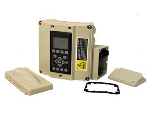

You cannot service the drive. You replace the motor and drive as a unit.
No I am not. I am calling Pentair this morning to seek some kind of advice. The pump worked fine all season long last year (that was the 2nd season with the pump).
What is the drive then? Are you talking about the electric module on top?
That’s almost the cost of a new friggin pump.
That is correct. Essentially, the Intelliflo pumps are not repairable. You replace them. Luckily, the last many years in most circumstances. We rarely hear of one failing before 7+ years. Yours is the exception.
