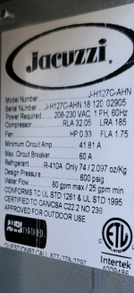

It seem liken im having the same issue. I have a Jh127c-ahn. That turns on just fine but once the heater turns on it trips my breaker inside my garage. I have a breaker outside and one inside. Photos are attached. Let me know what you think. I have replaced capacitors in case and the 60amp breaker inside, but it keeps shutting off. Any help would be appreciated.
