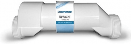

Is the cell type written on the side of it?

Yes, it is written on the side of the cell. The example below shows a T-15 Cell:
If the unit is set to a T-9, the salt will read higher than it should.

Hey, slow day at work for me. I was able to go through some photos. It is a TCell940 that is installed.

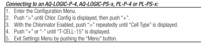

I found this PDF.
Looks like I need to change it to a T-15 (Or T-940 if the option is there?)
This seems logical to you I presume? Also thanks again for the help!!
Screenshot from the PDF:
*Edit* also looks like I incorrectly have been calling it an Omnilogic system, when its clearly an OmniPL system. My bad. I've edited my post to reflect the correct term.

You nailed it! Super slow day at work, went home at lunch and checked the setting. I changed it to the T-15(T-940) setting. It's now reading 3,628 ppm (and falling - at first it said 3,800 ppm). Going to keep my eye on it for the next few days. One other question, do you think that this will impact the chlorine generated? I'll keep my eye on it, but I had to set it at 11% to keep it in check. I'll probably have to revisit that setting if it is impacted.
The setting only affects the displayed salt level and alarming in the unit based upon the amps used. If the amps are too high for the version of the cell, the unit shuts down the cell and gives a high amps warning. The amps and salt level readings are directly related along with the size of the SWG plates (i.e. cell version).
